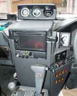

Yup.
Software glitches, Was supposed to work with back up cam but doesn't. There is a workaround tho'. Lately having poor reception issues but might be an antenna problem. Haven't had time to check it out yet. Plays DVDs fine, works fine with SD cards and USB, Bluetooth works ok but could use a better mic, radio sounds fine. I would buy it again if I had to.
john
john

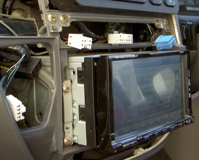

Re: Radios
Hi,
I am shopping for a sterio deck, is the mount bracket for the deck the same as a montero?
Aaron

Re: Radios
Mine did not need a mounting bracket - everything came included and fit my Deli as a 7" stereo. Had to remove the old bracket with the original stereo.solanoid wrote:Hi,
Aaron

Re: Radios
IC,
Thanks for the reply, so it was easy? any old sterio shop should have no prob doing this for me.

Re: Radios
Any good stereo shop should be able to do it. The one I used unfortunately destroyed my bezel by trying to remove it incorrectly - even after I gave them the directions and cautioned them that it was brittle....
But other than that it works.
The fact that I can run iGo8 on it for navigation software is a big bonus. The fact that my model does not have buttons that light up at night kind of sucks though.
