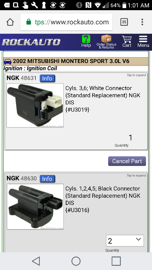

My delica is misfiring badly and hesitates at low rpm, even died a couple times while stopped in drive. I can smell that it's running rich as well. I'm thinking it's probably the ignition coils. Would like to hear somebody else's opinion on this as well.
Are these the right ones for a 2002 Delica v6?

Looking at it again, looks more like this one
http://www.rockauto.com/en/catalog/dodg ... +coil,7060

Before you buy from Rockauto check out the correct part number from Amayama or Megazip. Rockauto is a PITA to deal with, often it's better to spend more and buy from CCA or Rising Sun. They all have their quirks but thus the joy of owning a delica.

Hi lazygreenfox,
Turned out Lordco has the coils, so I just bought one to try out... No returns, but worst case, I'm out 60 bucks or so and I get a spare.
If I'm not mistaken, 1996 Dodge Stealth 3.0 V6 DOHC has the same coils, looks the same in any case..

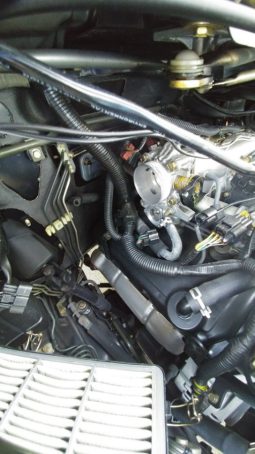

Let's just say the plugs are beyond my DIY comfort level for now lol.. Case in point, after cleaning the IAC and throttle body, I now have a misfire AND slightly erratic idle lol... In any case, for various reasons time is of the essence, and if the new coil doesn't solve the problem I'll have to tow the van to CVI to have a look

it sounds like you're on the right track. An observation that's probably not related to your current misfire issue: 30,000km is super low for a 15 year old vehicle, only 2000km a year! I'm hoping it had a full service when it was imported, but if not I would be changing all the fluids. Engine oil, transmission fluid, transfer case and differential oils, brake fluid (definitely brake fluid!) and coolant. Low mileage is good for the metal bits, but not so good for rubber seals and fluids.

I'd expect the engine compartment to look like that w 30K Kms. How was it rated at the auctions?
Is it really that clean throughout the entire van? Does it have a new van smell? Mine was at 32k kms.
I'm not asking to criticise but to complement you on an awesome purchase. You should be very happy with your van.... but...... expect a few problems. If you're rich I'd take it to CCA on Van island and give them a free hand. You'll never look back. Otherwise buy some tools there's lots to do. Do you have a garage?
I have more ideas about your idle problem. Looks like you're in the lower mainland so if you want to talk PM me and we can exchange ph numbers. I'm retired and have lots of time till fishing season starts in a month.

Thanks lazygreenfox. I wouldn't say there was a new van smell, but the interior was pristine, as you'd expect.thelazygreenfox wrote:I'd expect the engine compartment to look like that w 30K Kms. How was it rated at the auctions?
Unfortunately I don't have a garage, it's always cold when I DIY.
It's very kind of you to offer, I will send you a PM
