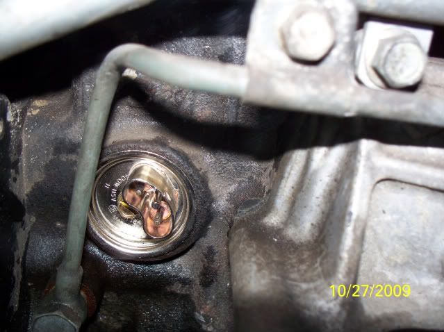

block heater sucessfully installed l400
pajerry
Posts: 501
Re: block heater sucessfully installed l400
Post by pajerry »
Excuse my ignorance, but which delica has the 4m40, and which heater would that be? I talked to sahir at maximum overdrive, and he was happy to give me a part number that lordco had in stock. First I'd like to confirm that it is in fact a 35mm plug and that I install it on the right side (from drivers perspective) and that it's the plug at the rear of the engine. Also, since I have never installed a block heater, are there any tips specific to this motor that would make my life, and the pajeros life easier.
Thanks in advance!
Manitoba deli
Posts: 431
Joined: Fri Sep 18, 2009 9:08 pm
Vehicle: 94 l300, 94 l400 lwb, 97 l400 S II
Location: Manitoba
Post by Manitoba deli »
I'm pretty sure the block heater I installed on my 4M40 in the l400 was a 40mm frost plug.
Jason
DelicaFreaka
Posts: 113
Joined: Sat Oct 03, 2009 9:03 pm
Vehicle: 94 L400 4M40
Location: Okanagan B.C.
Post by DelicaFreaka »
Manitoba deli wrote:I'm pretty sure the block heater I installed on my 4M40 in the l400 was a 40mm frost plug.
Jason
You are correct Jason it is 40mm.
Zero Start Brand
Part #3100049
Available at Lordco
********** Starship Delica **********
"To boldly go where no man has gone before"
Erebus
Posts: 1369
Vehicle: 1992 Super Exceed
Location: Edmonton, Alberta
Post by Erebus »
Ummm, the 4M40 in the zerostart catalogue is listed for the Mitsu Fuso, not the Delica.
You'd better make absolutely positively sure of which frost plug and what part number heater, because once that frost plug is out, you are committed.
DelicaFreaka
Posts: 113
Erebus wrote:Ummm, the 4M40 in the zerostart catalogue is listed for the Mitsu Fuso, not the Delica.
A piccy is worth a thousand doubters......................Kirk out.
Green1
Posts: 3257
Post by Green1 »
4M40 is in fact the L400 engine.
