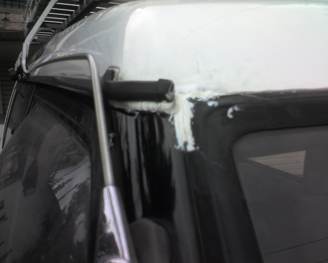

Okay, so I think I finally licked this one. After reading some other threads, I discovered the stress fractures at the top of the door pillars. Gooped them with some 'sikaflex' (I think it's called), and so far, no more wet carpets.
My question to the more knowledgeable maintainers: can those stress fractures be welded up?

Hi, the best way if you have time is to do re-seal all the windshield, but not all need to do the windshield seal.
as thru my experience i always do seal the front panel inner & outer panel joint using glass poly-urethane glue.
then if its still leaking then do the window for a complete windshield seal.
its just the front panel is always the first one that crack the joint as for oldness & the weather condition in japan, very hot & then cold with rain.
