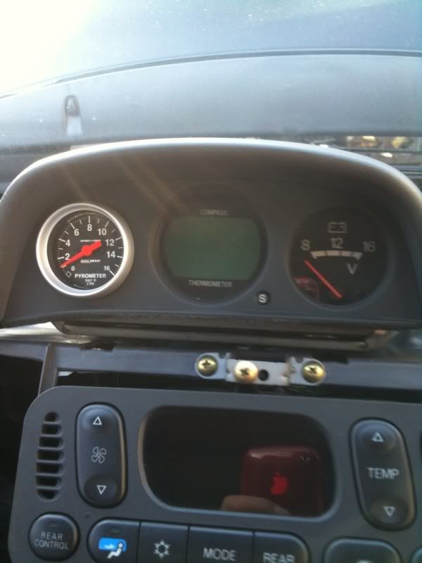

This is the exhaust side with the pyro bung Tig welded in and the probe , ready to bolt in. some say you can just bolt it right down, I prefer to put some copper RTV sealant its heat activated so you will be sure to have a good seal, and regular RTV on the Aluminium side, this way you know you have a good air tight lock, Very important when your trying to get as much boost as possible.
On an L400 this is where I ran the wires, I got a little messy with the copper goo, but this is what it looks like
