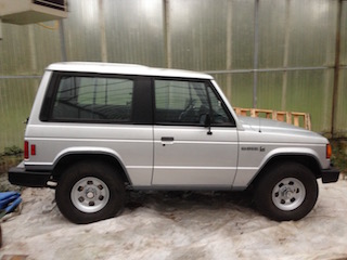

by mitsubill
Well just to show it does exist, really happy with the way it turned out, just waiting for collector plates for it and some nice weather then we will take it out and show it off..... now that the 88 is done I can get back to the 91 Paj, but now that I have seen that V55 of yours Phil, might set my eyes to wander, maybe if the exchange rate comes down a bit might have to start looking...lol
