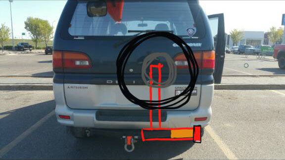

I've got a simple plan for those of us with a trailer hitch in the rear. Just bumping this so I can find it on taptalk and post a picture
Re: Spare Tire
Posted: Wed Sep 09, 2015 10:04 am
by Krazyistkarl
Excuse the poor drawings, done quickly with a stylus on my phone. The tire will sit as low as possible, it looks high in the drawing, and is blocking my reverse light and brake light, it will need to be centred.

Re: Spare Tire
Posted: Mon Sep 14, 2015 1:19 am
by Krazyistkarl
well just realized the picture didn't work
Re: Spare Tire
Posted: Wed Sep 16, 2015 10:19 pm
by FalcoColumbarius
The picture files are too big. You need to reduce the file size.
