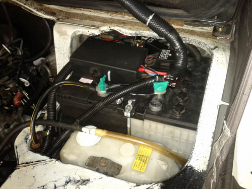

by Growlerbearnz
On an L300 the battery box is large enough for two batteries side by side like so:
