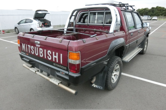

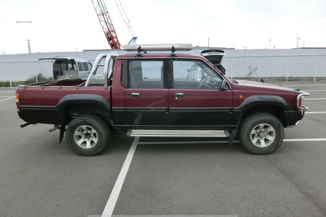

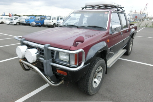

-1992 Strada R quad cab 4x4 5 speed manual, 4D56 turbo diesel, 104,000 kms
-Graded 3-C at auction, based on peeling clear on hood/roof, and seats torn in the usual places on the vinyl sides...
-aside from these faults, it appears to be in decent shape,
Roofrack/basket, light bar, bull bar, rear bumper, side steps and rollbar are all in place. Tonneau bars and hooks are present, but cover is MIA. MOMO Evo steering wheel is swapped in, but has some damage, extent of which remains to be seen. Winter spec means two batteries, which is a help.

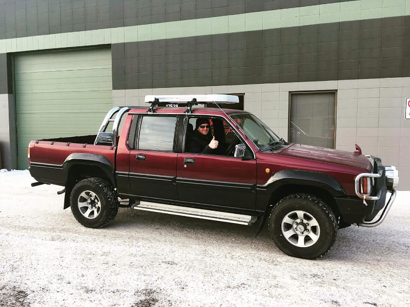

Passed out of province with no deficiencies! Interior needs a good cleaning, and clear is delaminating from hood/roof but otherwise? Mechanically very sound, starts great in subzero temps, and had timing belt done 20k ago. Also, maintenance records since new in glove box. So... so far, so good!

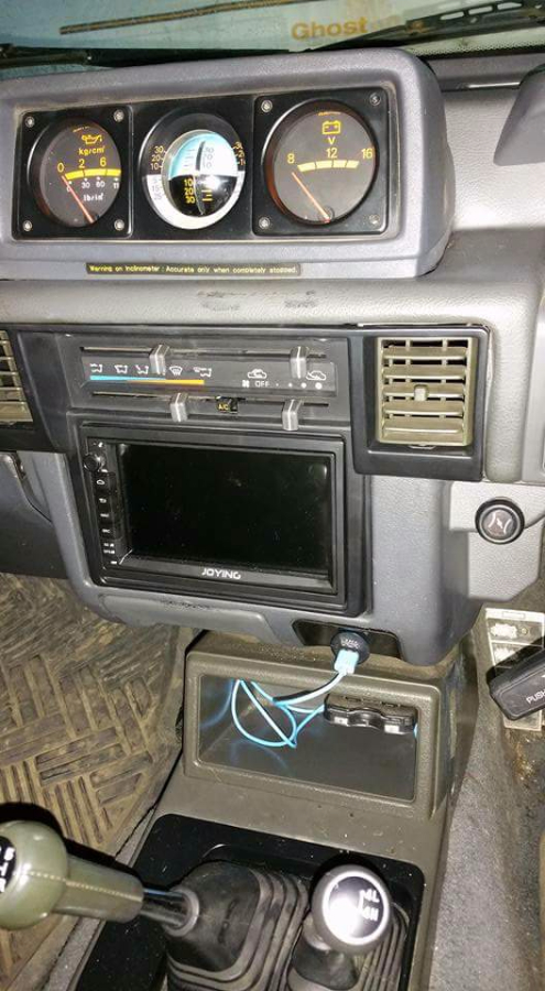

This week I started on the inside... replaced dash center bezel (original cracked taking it out), installed an Android headunit, and swapped the worn out seats for some Pajero Evolution Recaros I just happened to have a second set of. Also installed a Pajero triple guage pod at the top of the dash.
Recaro compared to OE
New in dash Android, and guage pod mounted...
Seats finished:

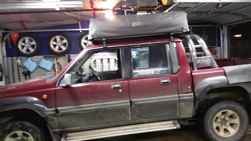

Bad squealing noise at 2500rpm, Turned out to be the AC belt tensioner. New bearing being sourced this week. Otherwise... oil change, and completely stripped the interior (again) to shampoo carpets, seats, mats. Even did the headliner. LOL. Have replacement sunvisors to replace my broken ones, and hub covers to dress up the wheels. Biggest mod this month though, is my rooftop tent! Test fitted it the other day.
ARB mounted on Surco bars. Just barely clears my garage door!
