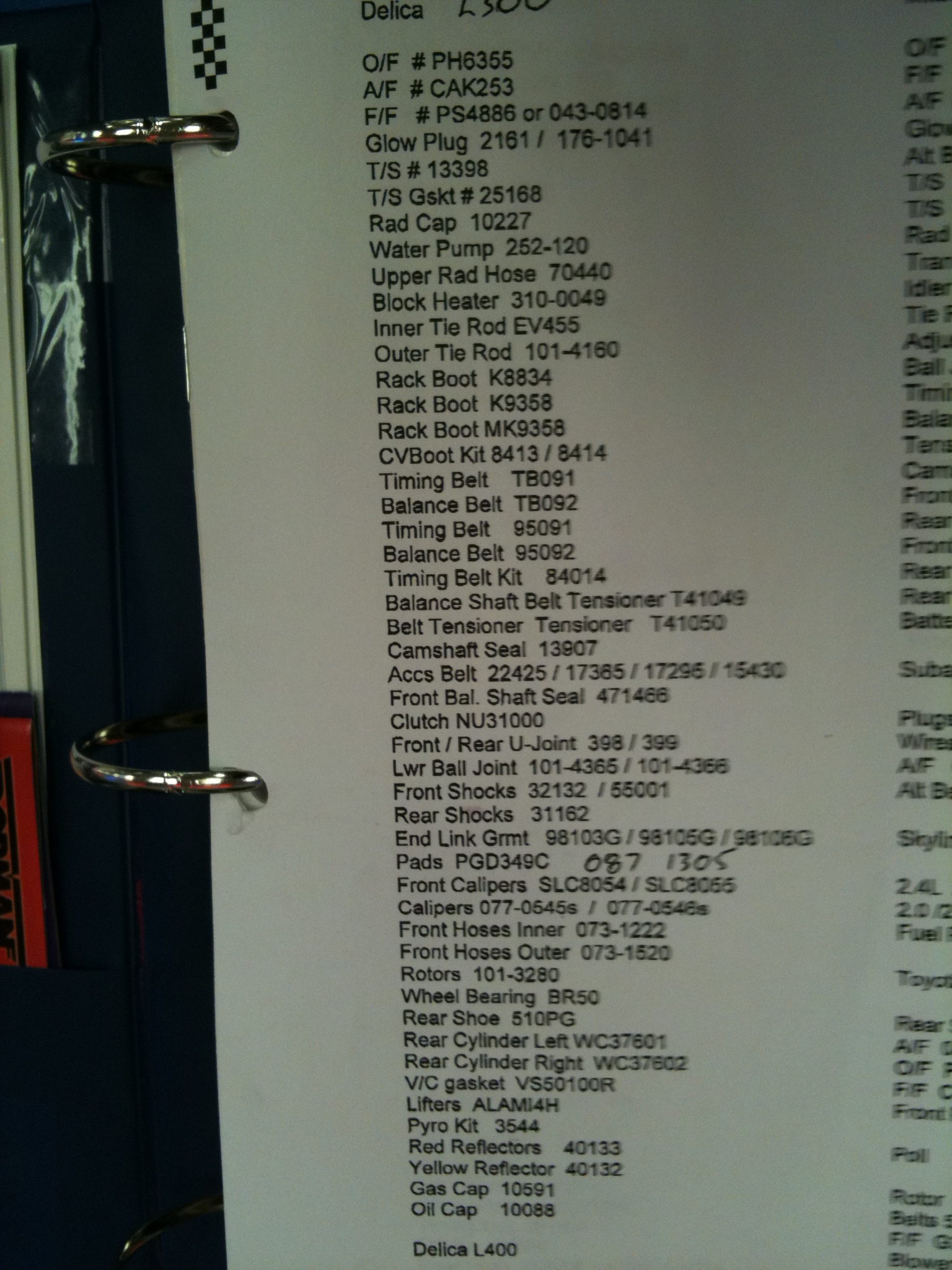

Yer gonna laugh, but here is an iphone snapshot of the L300 list from Lordco's internal cheat sheet.
Note the rotors 101-3280

That parts list is awesome!!! Thanks for that.

Rich, that's even better than secret agent micro film! Which store did you get that from?
Kingsway

That is sweet !! no more trying to figure out what the heck to ask for !
I am going to use that info right now..
rad cap
rotors
pads
and shocks !!
This needs to become a sticky !!
