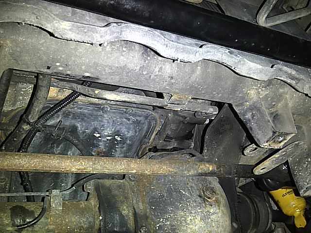

Removed the trailer hitch from Blueberry. It was a hood destroyer waiting to happen. And seeing as I have no trailer, I figured I could save some weight. Turned out the hitch was about 40lbs.
Previous owner lost keys so removal involved crappy little hacksaw. Took nearly and hour. Now icing shoulder.

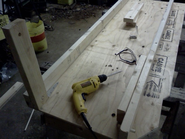

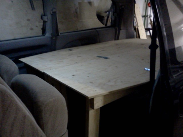

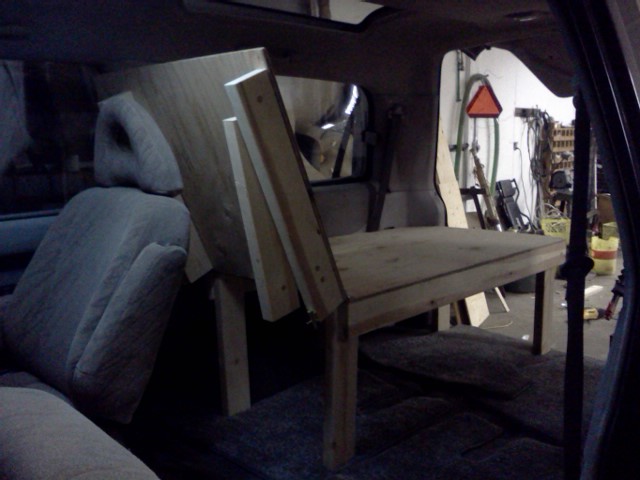

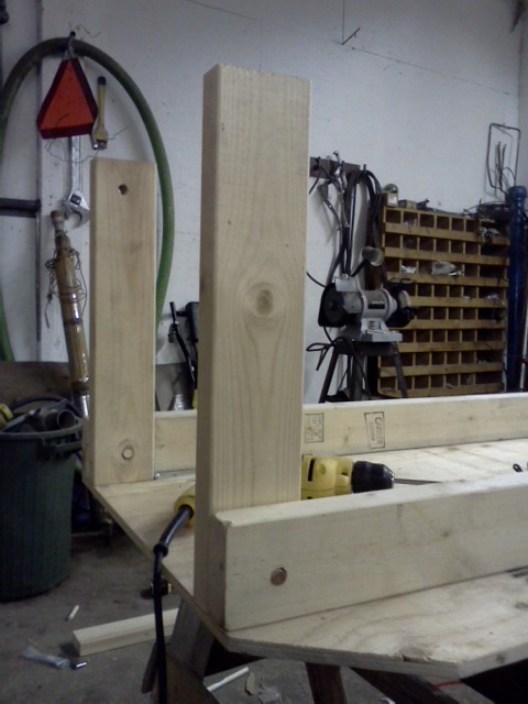

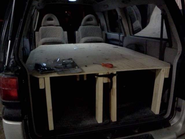

I put a bed in the back of my L400, using the idea I found that someone posted on photobucket at this link:
http://photobucket.com/images/Delica+L400+LWB+bed/
Mine is a little taller - I can fit a tall Rubbermaid tote (or two stacked half sized ones) underneath the bed, and I put the legs on hinges so I can fold them up out of the way when storing the bed, or move them out of the way to fit large bulky items under it. It also hinges near the front as shown in the pictures so I can still carry 3 other bodies with me some place.
I just used the bed for the first time this week - excellent! Very functional, and easy to get at the stuff underneath. Now to find curtains and a rear wiper...
Enjoy the pics!

- completely folded with no mattress.
- IMG201.jpg (91.81 KiB) Viewed 6479 times
- Dowel-locked hunged legs
- IMG200.jpg (73.98 KiB) Viewed 6479 times
- From the rear :)
- IMG199.jpg (78.13 KiB) Viewed 6479 times
- Completed double sized bed platform
- IMG198.jpg (72.47 KiB) Viewed 6479 times
- Folded for passenger cartage - this is how I run it with a 3" foamy in it, so it doesn't crease the mattress. Also forms a bulkead to prevent forward movement of cargo in the event of a sudden stop.
- IMG196.jpg (89.36 KiB) Viewed 6479 times
- Under construction
- IMG195.jpg (99.26 KiB) Viewed 6479 times
