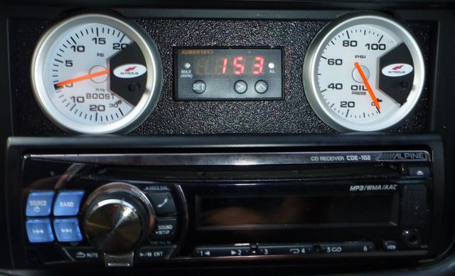

So here's what I finally got mounted in my van. Auber Pyrometer with an Autometer EGT probe (installed in the exhaust manifold not the EGR blanking plate). Boost and Oil Pressure Gauges from Harbor Freight in the US. Bad sending unit on the Oil Pressure Gauge. Have to replace that to get it working. What do you expect for $25?
Thanks for the great work Laurentiu.

Did you just replace the stock oil pressure sender with aftermarket for the oil pressure guage? Wanting to put one in.
Also, anyone know how where would be the best/easiest place to tap into for trans. temp and coolant temp?
