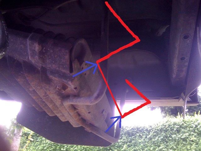

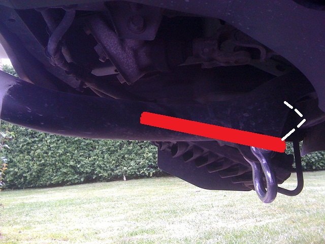

So I looked at it again today, and I think there's a way I could do this without cutting or welding, or really doing much in the way of alterations. I think I could just bend the brackets holding the rad to the van at 90 degrees to pull it up just above the protection of the bullbars. I made a super crude drawing as shown below:
Here's a side view so you can see how it should be able to be above the bullbar line. This should be able to be done with a torch and a vice I would think...
My only concern is if this is going to be an okay mod in terms of long term strength. The brackets aren't holding much weight so I can't see it being a problem?

Seems to me that the little side steps protect them well. Also some pieces of steel pipe could be added from the bull bar around the radiator to the frame on the other side of the radiator. One piece at the top of the radiator and the other of at the bottom then a skid plate could be added between the pieces of pipe with some holes to allow air flow. Thats how I would start to look at the problem, but I am by no means an expert, and I just took look to see how I would start.
I just don't like the idea of bending the bracket because if something manages to hit the radiator, instead transferring the energy strait into the frame it would pull on the on bolts or push on the bends made in the brackets. Over time it may break!
If off-road/back road is going to be the main use, or even occasionally, I believe doing it the best way is a good idea because allot of stress is being put on everything and you dont want something to break well out in the boonies. The best way may require welding and such!
Thats my opinion, I may be wrong.
