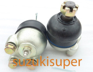

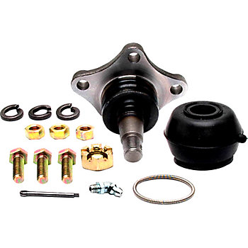

This has been documented already in the L400 tech section. I posted the difference between the two.
Montero and L400 upper control arms are different = upper balljoints are different = not interchangeable
As for Paul's reference to the Series I vs. Series II drivetrain goes, both are identical. This as well has been documented in the L400 tech section.
With regards to the lower balljoint, you 'can' use a montero/pajero with a mild modification if you absolutely must. Modification required : The grease nipple has to be removed and sealed shut as it is located in a position on the balljoint casing that rubs up against the inner lower control arm bracket making the install a near impossibility.
Jesse
*edit* I've posted pictures of the two so you can see the difference
