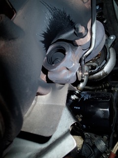

My van broke down :((( I am stuck in Helena Montana...So about 10 miles out of town last night I heard a loud noises followed by some sparks at the back so I pulled over and could not see anything hanging or nothing...WHen I started it again, it was running a lot louder, but everything seemed smoth, so I drove into town into the Walmart parking where I spent the night. With my panic, I also overfilled the oil so when I started this morning, I drove 100m away before I got some wicked smoke effect... Here is a picture of where it blew I think. HELP anyone....

You have somehow lost your waste gate cover plate. welding one on is not a good option. Don't think it is a serviceable part, may need to simply replace the turbo ( check first, as I have no idea) Your turbo is a td-04 9b( if memory serves... Chime in boys). I believe the dodge stealth 3000gt uses the same turbo (Mitsubishi eclipse etc..)

So it's been confirmed by the mecanic here that it is the turbo waste gate cover plate, so I need to source a new turbo, anyone can help with that?
