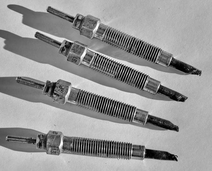

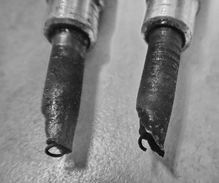

I have the same experience with Hyundai glow plugs as everyone else in this thread. I got them installed at CVI in October 2011 and as the mornings are getting cooler this fall I realized that it was time to replace them again. I went with NGK CY55's for the same price as Hyundai ones this time.

Profister wrote:I have the same experience with Hyundai glow plugs as everyone else in this thread. I got them installed at CVI in October 2011 and as the mornings are getting cooler this fall I realized that it was time to replace them again. I went with NGK CY55's for the same price as crappy Hyundai ones this time.
OUCH!
I hope your heads are ok!

You have run your delica under abnormal glow plug relay system for a long time as power continuously went into glow plug.Profister wrote:I have the same experience with Hyundai glow plugs as everyone else in this thread. I got them installed at CVI in October 2011 and as the mornings are getting cooler this fall I realized that it was time to replace them again. I went with NGK CY55's for the same price as crappy Hyundai ones this time.
This one could happen to all kind of glow plugs when your glow plug relay has failed , but you tried to start the van in certain period without fixing.

For all 4 to be burnt off like that, definitely something wrong with the system. Once in a while, a tip may burn off, but for all 4, I suspect your relay stuck on at one point, or the ecu is starting to malfunction causing them to stay on too long. If one tip was burnt off, and a couple others burnt out, I would say could be because of cheap plugs. All 4 burnt off= system problem. Or you had some wickedly hot burning fuel.

Relays don't get "stuck on." There needs to be power to a relay to move the armature and close the circuit. Without power the armature will spring back.

Relay's do stick on, when they get older, and the contacts get dirtier, when they are activated by the signal voltage, arcing can occur between the main contacts, essentially welding them together, keeping the voltage flowing. If your lucky, when it gets hot enough, the contacts will let go. If your not so lucky, the relay eventually gets so hot it catches fire. Either way, relays can and do stick on. If you are changing your glowplug relay, make sure you replace it with one that can handle the amperage draw of the glow plugs. Minimum of 60amps. 80amps would be better.

What? Where did you get this from? It looks like you are talking about someone else; I have never had any problems like that.Rising Sun Auto Import wrote:You have run your delica under abnormal glow plug relay system for a long time as power continuously went into glow plug.
Steven
The reason for my post was to confirm what the OP and other drivers were telling about Hyundai glow plugs floating around. That's it. Somehow I am the only one to blame on doing something wrong.

I checked my system by Installing a light so I know when they are on and when they turn off and everything seems good and never had any other glow plug tips burn off before..... I just had the one tip burn off but the others were not far off.
my suggestion would be to check them out to see any signs of wear if you have these plugs just to be safe

The glow plugs on the picture did not brake down at once; they were slowly burning over time. Don't you get it? What damage do you expect to see because of that?
