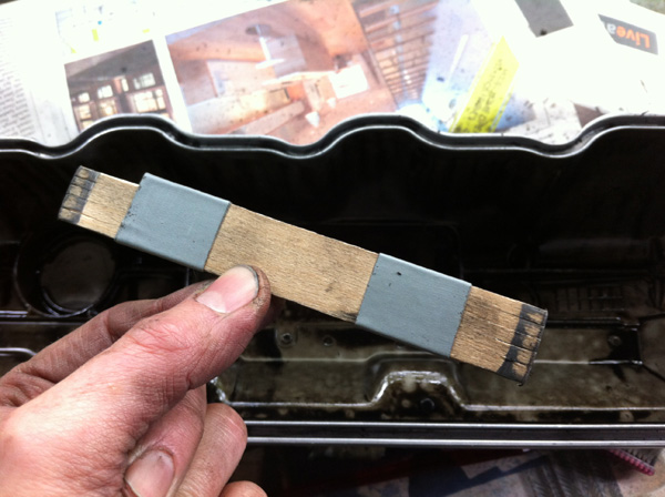

My tool of choice for this cleanup, better than brass brushes, Scotchbrite, or jamming rags in the groove was this:
It's a tongue depressor, cut at 90 degrees to get rid of the rounded end, then split into 5 pieces, and tape wrapped around to keep it from splitting any further. I scrubbed back and forth in the groove, like a broom, and because of the splits it would curve around corners, especially useful on the glow plugs side where nothing's a straight line. It rubbed the debris into little, snake-like goobers, that I whisked out with a toothbrush.

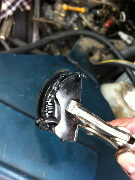

I read somewhere, to get the half moon seal out you just reach back there and pop it out with your fingers. I had to get small vice grips on it, and you can see there was quite a bit of goop holding it in place. See the importance of applying only a small bead of Permatex Black when reinstalling.
Also note, I replaced the rubber half moon with an aluminum one, from Harold Zeigler Mitsubishi, Kalamazoo Michigan, Part#MD372348. When this thing arrived, I thought it can't possibly be the right one, it's too small, but it fit perfectly.

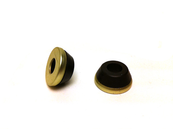

And the other mystery, when I ordered my gasket, it came with two rubber seals, which I installed around the bolts that go through the head cover...and it also came with two more, similar seals (these ones with metal cups on the back) which I didn't use because they're for larger bolts than the ones in my engine. Anybody know about this? Are there Deli engines with valve cover bolts larger than the ones with 12mm heads on my engine?
Got a couple of leftover rubber seals. PM me if you need some for your larger bolts. ;)
