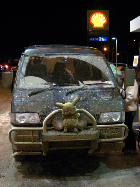

Hi everyone,
New to Canada, coming from France, I settled up with my girlfriend in the Kootenays along Kootenay lake. I now have to deal with our Delica, and try to fix all the issues we are having with that 1993 model.
So that's why I'm here now, as I was trying to find some information about gaskets and everything.
Dealing with a Delica here seems to be quite challenging. Even though when we were living in Vancouver. Now, so far away, I guess I'll need the community of the Delica club to learn how to deal with that. Mechanic, spare pieces....
So, I'd like you to be patient and understanding with me, because of the cultural gap, and language gap. I've learnt english at school, where "Where is Bryan ? Brian is in the kitchen" was the lesson. Now I need to deal with gasket goops, glow plugs, ECU, bus bar.... and where try to find all the parts.
I've already tried LordCo in Creston... and felt very lonely...
"Just in case, do you have parts for Delica ?"
"For what ?"
"That Delica out there, outisde !"
"Whooow man, that's a right hand side... well good luck with that...."
So first, I just know this van is a Delica from 1993. With a 2.4 engine size. I guess it's an Exceed... I guess also that it's a L300, and the engine a 4D5, as far as it looks like the one on the wiki.
May be you are going to be able to help me making sure that's the right one first.
Because now, I have to change to valve cover gasket, because I have a leak on the bottom of the half moon that is located in the back of the engine.
Reading the tutoriel I found here, I understood I have to get a kit, but didn't understood all the process, and where to add sealent and goop.
So, may be I'll have to ask all these questions, and more about glow plugs on the right forum...
See you, and thanks for your help...
