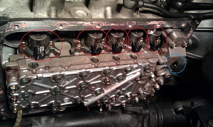

I have an update, I dropped the automatic transmission pan yesterday and drained the fluids. There were no big metal chunks and for the most part the fluid was decent. The magnets had a very fine metallic dust on them which is normal so that is a good sign. I was able to put an ohm meter on each solenoid and they all were at exactly 3ohms. I then moved to apply 12V to each and all made a consistent clicking sound.
I have three things I would like some input/advice on if anyone knows.
1.) Are there markings somewhere on the Tranny that will indicate exactly which model/type it is and if so where do I find them?
2.) Is there a possibility that even though the solenoids sound okay they are not? I ask because the error code told me that Solenoid No. 2 had a short and they all passed the Ohm/Voltage test.
3.) I have attached a photo (solenoids circled in red) does anyone know which one is solenoid no 2?
4.) In the attached photo I circled one item in light blue does anyone know what that is? It had a slightly different connector and measured 3.2k Ohm, thus I did not apply 12V to it.
5.) Any other ideas/input as to what my issue might be?
Thank you for all the feedback thusfar

Since the code was "open or short" I would check all the wiring and connections right from the solinoids to the controller boxes. basically inspect all wiring, and take apart all plugs and inspect inside for corrosion or loose/broken connectors. Also, check all ground connections, these must be good for the electronics to function correctly. Did you try disconnecting the battery for 20 minutes or so to reset things and then try the tranny? I have a series 2 here in good working condition that I can test components on and compare to yours, but I will not be able to do so untill the 17th at the earliest. Hope this can be of some help to you.

Another update, the one sensor that is different (circled in light blue) is the oil temperature sensor.
