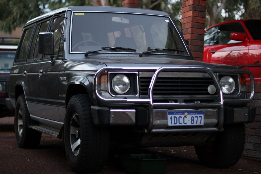

Requires a head gasket. Other than that, a solid unit!
Within' 24 hours I started purchasing parts to get it up to snuff and aid in my travels. Currently stationed in Perth, WA.
