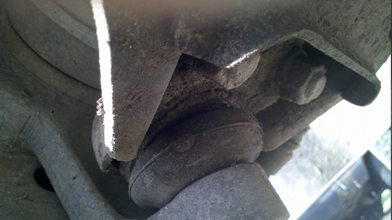

- comments?

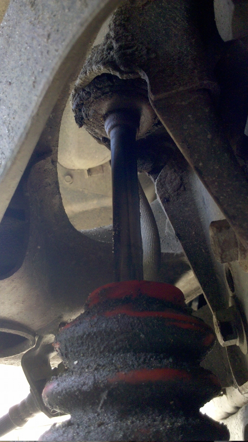

- comments?

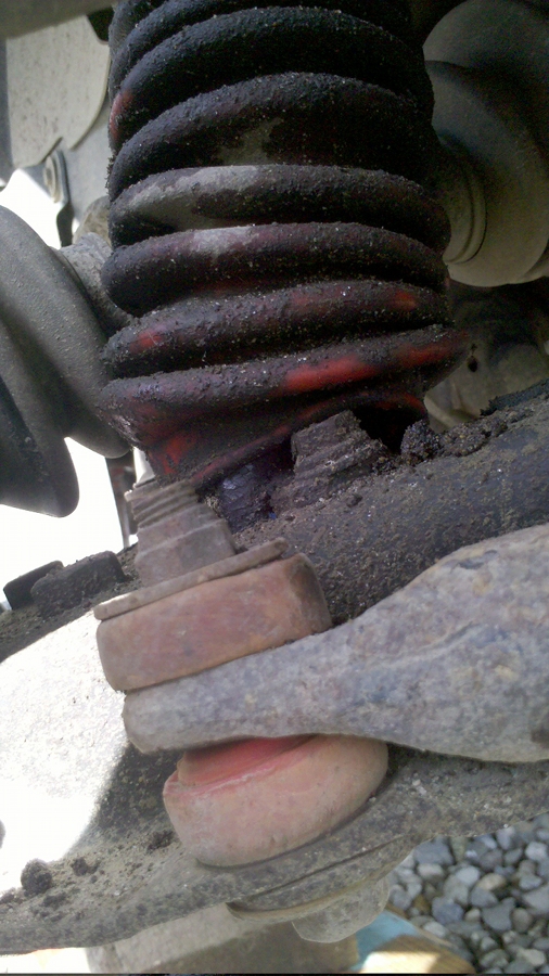

- comments?

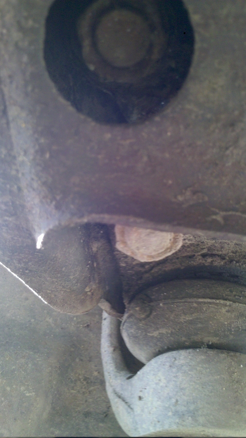

- there's the bottom, and in the foreground, bushings? I've always wondered about those, they never appear to be a sweet fit, but I don't know what they are supposed to look like.

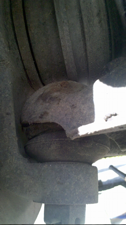

- see, it looks pretty icky up at the top, and the passenger side shock boot is safe and secure. This one looks rotten in comparison

cut the boot off you do not need it...
the noise:
bushings control arm
bushings bottom of the shocks (RUBBER fails)
bolts holding front subframe loose
sway bar
loose ball joints
the noise:
sway bar
loose ball joints

I tried moving the tire when jacked, you know, hands top and bottom of tire...no movement...does this mean my ball joints are ok?
it is rubber on the bottom of the shock, but it looks ok, superficial lines, not quite cracks...does a visual inspection rule out them as culprits?
as well, before dismantling everything, is there a visual indicator that the control arm bushings are spent?
I'll try tightening everything, take her for a spin to napa and buy some grease to shoot in the nipples.
thanks again.

The red/orange thing is the anti roll bar bush and it should be way tighter, its aftermarket material, as the original is black rubber, and prone to being noisy/squeaky, and will also knock over bumps as its too loose.

Thanks yojimbo, i'll try that, i was always suspicious, bought it like that

Ball joint testing requires 2 different motions to test for wear.
1 you did by hand while feeling for lateral play.
The second method requires moving the front wheel up and down with a pry bar while the lower control arm is supported with a jack or jack stand. The pry bar test will tell you if the internal ball joint structure is worn out. There should be Zero up and down play in ball joints....when worn excessively they pop and squeak on every oscillation of the suspension. No amount of lube will fix them....thankfull there is ample supply at several JDM importers across the Vancouver, Richmond and Victoria Isl. areas.
And
The red boot is a shock dust boot and that can be cut off with no impact to your shocks performance....however the boot appears to have been coated with oil which would make me want to check the shocks for fluid loss. Youtube 'how to test shocks' if you are unfamiliar with the process.
Suspension Testing
http://www.youtube.com/watch?v=scFbb43f ... re=related
Shock test
http://www.youtube.com/watch?v=80C2N9ecSj4
The red bushings are eurethane bushings....you can try tightening the bolt and nut a bit more or you can buy a new set. Red denotes these are made Energy Suspension which is available just about everywhere in North America.
As for the cracking in your CV boot.....duct tape will work to get you home if a rip has occured but a new replacement boot or rebuilt CV axle are your only options. For the time it takes to get a CV axle out you should either replace both boots or just get a rebuilt CV axle.
