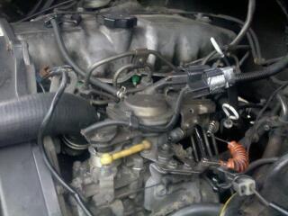

Picture of wheels dug in, the accelerator wouldn't stop...and a recent shot of top end

small photo

Have you tried sitting in the drivers seat while the engine cover is up, pressing the accelerator pedal and slowly releasing it, while watching the injection pump? It sounds like your cable is hanging for some reason, if you release the accelerator pedal carefully you should be able to see what's causing it to hang.
There are two return springs just inboard of that yellow plastic linkage, but even if one had broken the other should be enough to close the throttle.
Could it be that, since your kickdown cable isn't retracting, the cable or metal part got snagged or jammed somehow? You should be able to disconnect it from the injection pump (from memory there's a split pin that holds the pivot pin in) and tie it up away from the injection pump as a temporary fix.

it was the kickdown cable jammed up...our driveway is right off a hill...so...it's fixed now
