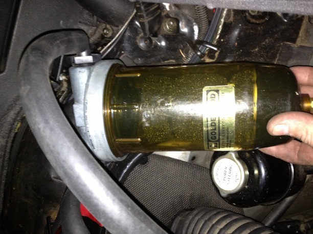

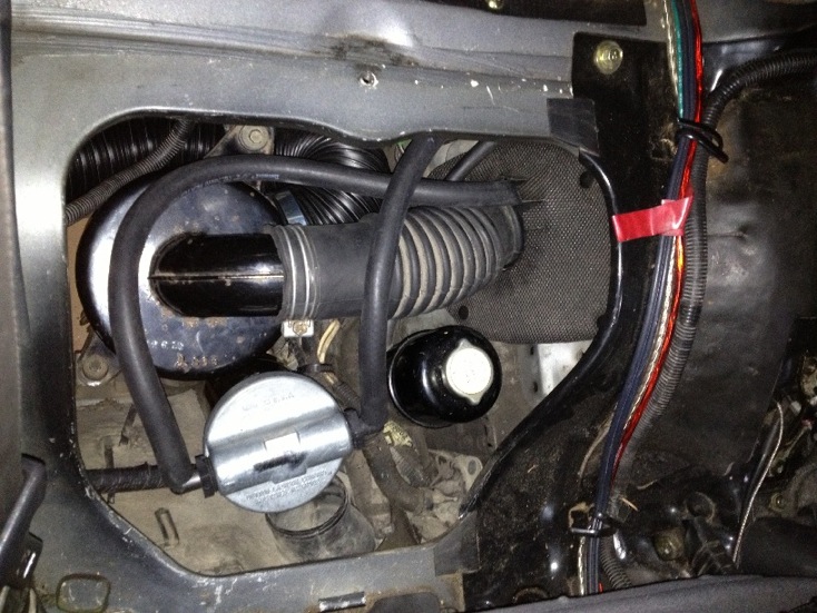

This has been done for a while, but thought I would post anyway. I installed the PCV bypass filter and new Snorkel. The filter is a canister style fuel filter from Princess Auto. It has 1" inlet/outlet, and a replaceable filter that has a louvered metal inside that works perfect as a baffle once the paper is removed. I used 5/8 heater hose with 1"-5/8 adapets at the housing. I simply used a modified wet-vac filter to wrap the baffle for added surface area to condense the oil vapor. Great deal for 40.00. The canister is clear so you can see when it needs to be drained, but also has a pep-cock for easier drainage. If I were really motivated, I would simply run a 3/8 hose directly from the canister bottom to the oil pan so I'd never have to worry about draining it like Volvo/Mercedes do.
The canister nestles nicely beside the air box. I left enough slack on the hoses to tuck it out of the way if I need access to anything.

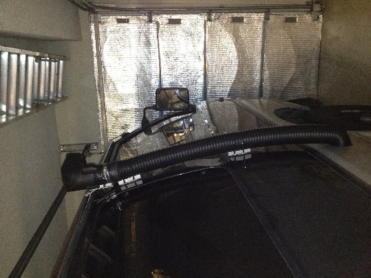

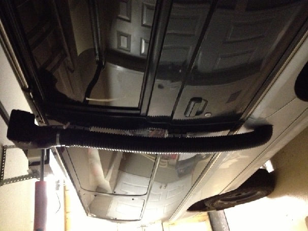

I also ran a new 3" corrugated hose for my snorkel at the same time.(as seen in the photo)
I was told it couldn't be done, but it worked great - it hardly distorted the hose at all, and I got away with no mods to the air canister but all the benefits of better air flow. Unless the outlet is modified to the canister there is no benefit to a larger inlet and the snorkel scoop provides the added air volume to pressurize to the box.
The hose is continuous from Snorkel head to canister. I know it looks a little "utilitarian" for some, but it does work great and was a very simple install. I originally mounted the hose up against the body but had some wind howl, a fellow experienced off road guy said to space it out to allow the wind not to "pocket" which worked well and solved the problem. Lucky for me that the Delica is not aerodynamic and creates a large low pressure area at speed:) If I intended to seriously offroad in the overgrowth I would reel it in a bit. The hose it pretty tough (metal reinforced PVC) so it can take a few hits if need be..
I bought the Snorkel head/ hose on Ebay together from the same supplier for 40.00 plus 20.00 shipping. It came Fedex to Canada in 4 days from Malaysia.
Looks like it sticks out further than it does because of the mirror effect off the body.
Nice to be able to run a continuous length...no possible leaks!

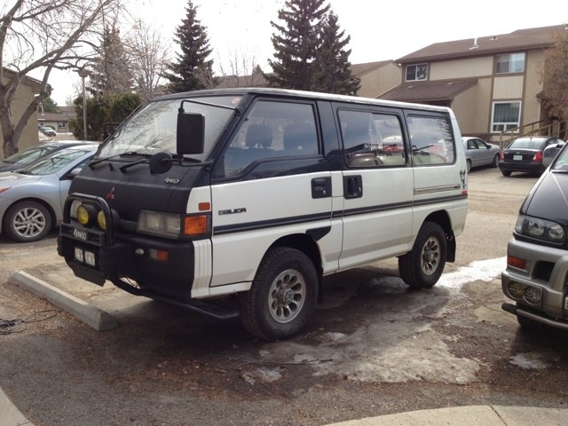

I decided I should do my normal spring stuff to my delica which is for sale. Can't help myself lol. Every spring I like to touch up the wheel wells and stuff that our gravel roads seem to like knocking off. A nice stiff wire brushing and some flat black to make it look sexy.
Rising Sun Auto Import
Posts: 1366
Firesong wrote:I decided I should do my normal spring stuff to my delica which is for sale. Can't help myself lol. Every spring I like to touch up the wheel wells and stuff that our gravel roads seem to like knocking off. A nice stiff wire brushing and some flat black to make it look sexy.
I believe your L300 will find a new home soon.

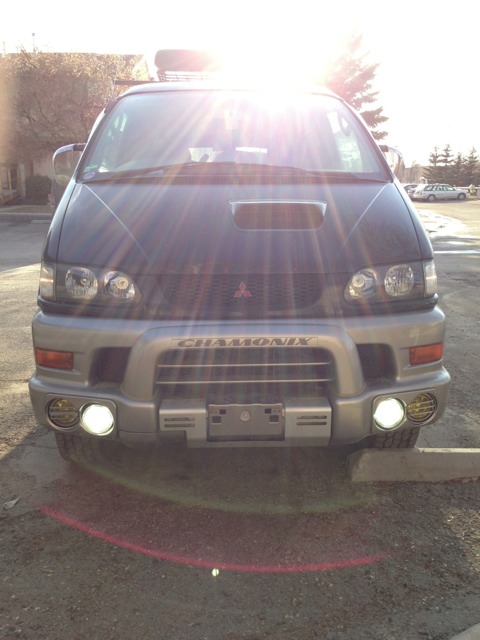

I got off my butt and replaced the 55w driving lights with my 18w LEDs
Should lower the amperage usage. Now I need to find where they hide the relay for them. I hate how they turn off when the brights come on.
They are quite bright. Something like 1950 ish lumins
