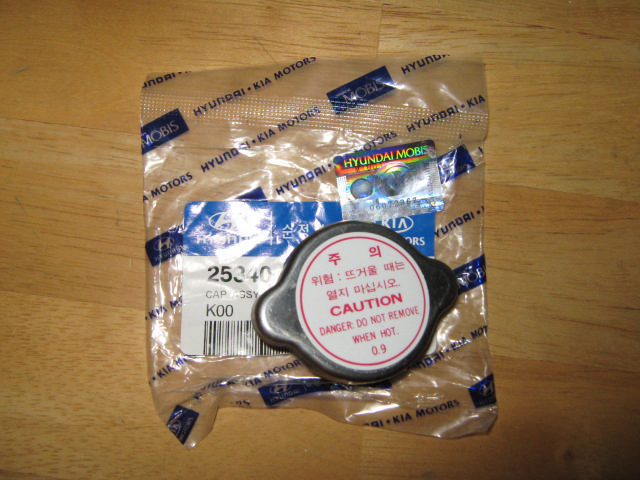

Can anyone confirm a part number for the radiator cap for a 1991 Delica? Hoping to get one from NAPA.

The seal from a 1980's For Ranger with the 2.5L Diesel engine works if that's all you need. I've also heard that some Hyundai ones work. If you bring in your current cap, they should be able to match it up for you.

25340-45000 is the Hyundai OEM number for 4D56T, go to local part store for cross reference.nxski wrote: I've also heard that some Hyundai ones work. If you bring in your current cap, they should be able to match it up for you.
Steven
- radiator cap 001.JPG (127.46 KiB) Viewed 4248 times

Thanks guys. Got one from napa this morning. Part Number 31333.
