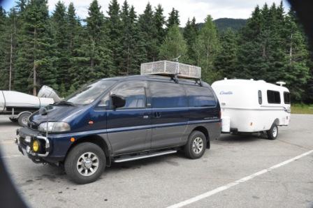

I put in an Airlift 1000 Airbag. Sorry can't remember the model number but it was for a 95 Montero. Fairly easy install.
My back end used to sag and bottom out every dip and bump.
- at britton Rest Area.jpg (67.15 KiB) Viewed 8300 times
