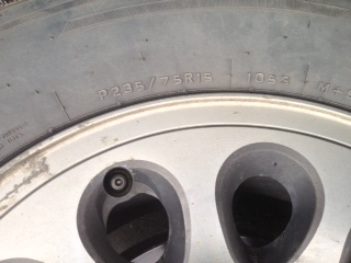

Here is a photo of my 235 75 R15s on my stock rims, no lift.

well.. i am embarassed......
the tires i have are 31x10.5 R 15, not the previously mentioned 235-75R15's.. apparently there was a mismatched wheel sitting with them.
So.. will a 31" tire fit on a Delica without jacking it up?? also, how wide of a rim do i need for a 10.5" tire?
