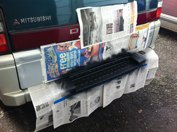

Spray painted my rear step today...

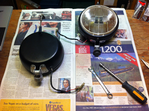

And spray painted my fog lamps, so here they are all put back together, freshly blackened:
I did a base coat with bed liner, and a top coat that's supposed to be tough; it's meant for rims. I'll be happy if it stays black for a few seasons.

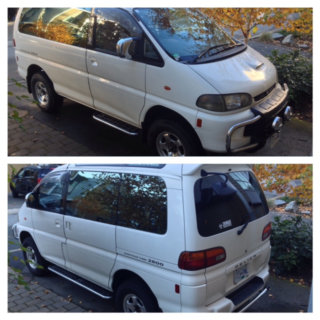

Hey guys, i'm new here! ...
Now that that's out of the way, like most of you I love to mess around with things, so i'm glad this forum exists. Here's the basics i've done so far.:

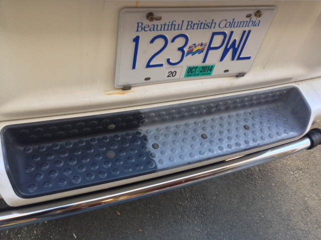

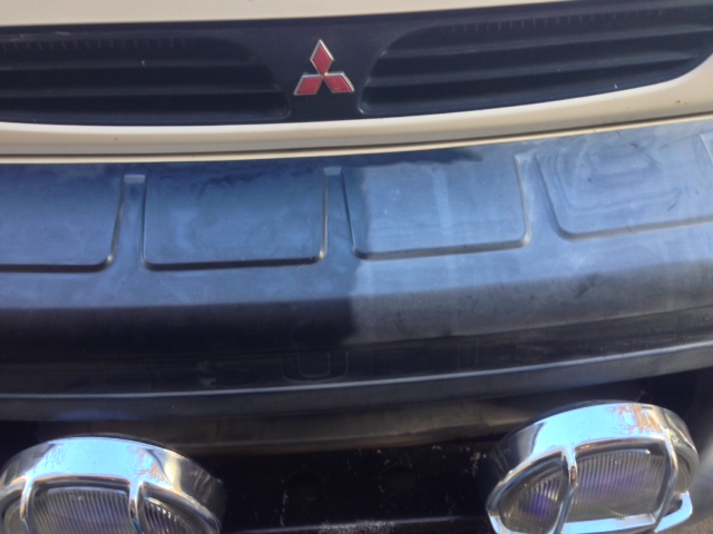

Brought the UV faded plastic back to it's former glory. Installed a 'zombie response vehicle' decal, very necessary. Got some new winter shoes. Which were great while I was walking around waiting for them to put the new winter tires on. Removed the old Japanese stereo system and CD changer. Replaced with a new deck. Sounded easy enough, only I got carried away and installed it late at night, with a dim headlamp at -15 for an increased difficulty rating (as is the 4 different existing wiring harnesses I pulled out make it confusing enough) . Started replacing the 17 year old horribly deteriorated paper cone speakers up front.
That's the basics so far (only had it a couple weeks) It's going to be used as a family vehicle and adventure vehicle so i'm going for the basic up grades first. I'd like to find a ladder, get a roof rack, hitch, next so I can strap various sports paraphernalia to it , fix the fog lamps and install central locking with a fob. These forums have been incredibly helpful so far, especially for things like panel removal and wiring.

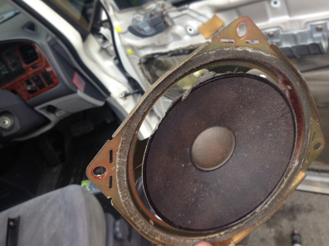

- I'm no expert, but I think these were shot

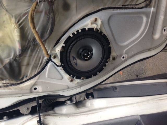

JSweet- what kind of speakers are those you put in the doors? They look like an exact fit.

The speaker are Alpine E series 6.5". The sound quality is actually pretty impressive the "e series" is their "economical" series, which basically means they can't handle a giant amp. They aren't very deep (no giant magnets) so they fit perfectly on the factory mounts, just have to drill a couple new pilot holes in the plastic. The guy threw them in when I bought the deck, I think I paid about $50 for the set.

What product did you use on the rear step? Looks like it worked really well.

I used a heat gun on the rear step and front bull bar plastic. I might try something like plastix or some other kind of treatment for it after to help protect it from UV but I was impressed on how quickly and easily the heat gun worked.

Auto Glym Vinyl & Rubber Care, you can get it at Canadian Tire for around $15. It restores the oils into the vinyl/plastic. Depending on how faded or blued the eaves are you may require two or three applications.JSweet wrote:Anyone had any luck restoring the wind/rain deflectors? Mine are less than transparent.
When you use a heat gun it draws the oil from deeper in the plastic closer to the surface, which makes it look darker. The drawback to this is the oil at the surface tends to evaporate, which is why it goes faded. The more oils leaving the vinyl, the more likely it will crack over time.
