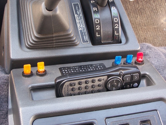

I have a switch that I turn on to operate the starter. The switch operates a relay which controls the starter solenoid. If it is not turned on some relays chatter which makes it sound like the battery is dead. Real cheap deterrent. Costs are the switch, relay and a bit of # 14 or 18 wire. You can put the switch wherever you want. Mine is in a bank of switches so the chance of operating it is small if you don't know what it's for.
Larry
Larry

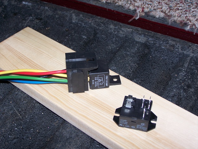

The relay coil is connected to a 12V source which is controlled by the switch. The control wire to the solenoid is cut and the 2 wires are now connected to the relay NO contact. With this system if you do not operate the start relay existing relays will click sounding like the starter is trying to engage when you turn the key. With the relay is operated the van starts like normal when you turn the key. I've attached a picture of a couple typical relays. The plug in unit with the wires is the type I used. They are available @ any auto supply store.
If you would like I could send you a schematic.

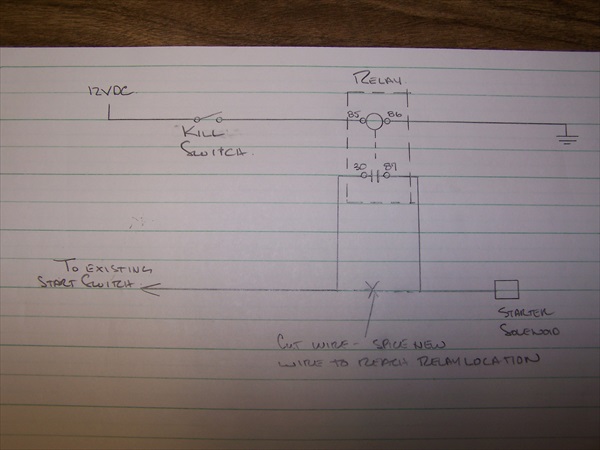

Here is the schematic. Hopefully it's dark enough you can read it. I mounted the relay near the fuel filter in the engine bay to cut down on wiring. Good luck on your project.
Larry
