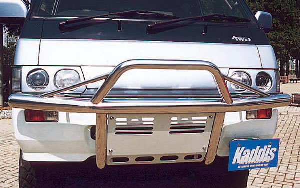

here's a tube type that is properly supported...not a winch mount type though.

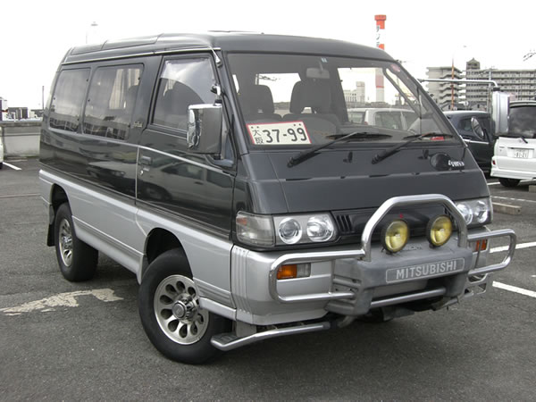

Here is another version of the Stock Bull Bar. Not sure if I will keep it or trade is for lower wings traditional one...
I am trying to insert a picture directly but its not working...
