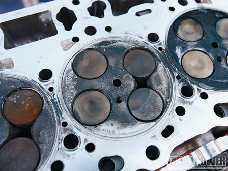

The Duramax Forum has a few pics of this kind of failure on their V8's.
Here's a sample pic of a 4 valve head. They tech stated the aluminum gets hot and starts to melt a small area....as the ignition cycles pound away ( even at idle 800 RPM or as high as 2400 RPM cruising) it wouldn't take long for catastropihc failure to occur.
Melted Durmax head.jpg (43.84 KiB) Viewed 8319 times
Cracks are a likely source for this heated area to get a toe hold...but it could certainly be made worse by a poor cooling system +/or excessive injection of fuel. My money is that the head on your 2.5L had cracks in critical areas that got progressively worse. Most of these guys do not recommend repairing a head that experienced excessive heat that caused melting to occur.
