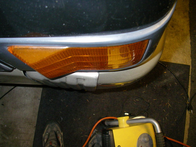

I noticed that my front bumper(Not the bull bar) is over toward the right side of the car about 1/4 to 1/2 inch. Does anyone know if this can be adjusted? The bumper is straight, and the supports underneath, from what I can tell, are not bent. It wouldn't be an issue, except that the plastic trim pieces that cover the ends don't line up well.

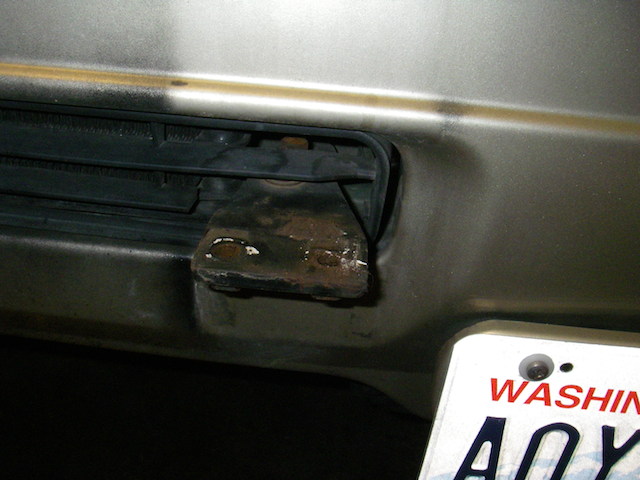

The photos show that the left side of the bumper as it wraps around the car, is slightly recessed from the headlamp surround, while the right side sits proud of the headlamp surround. The Bull bar mounts are also not symmetrical in the grille that they exit.

You're talking about the front lower body panel. That does look a little askew, doesn't it. It looks as though the right quarter is projecting and the left quarter has been pushed in a little. The upper and lower panels should line up (I just ran out and compared with my '92). If you go to the L300 Dedicated Category Reference Forum, in the Manual Downloads ~ there is a illustrated view of the underside in the Quick Reference Nipple Greasing Illustration. You can see the general shape of the frame. I'm wondering if either someone backed into the left quarter panel or maybe the previous owner slid into a tree or something. My guess, without crawling under my wagon would be to examine that part of the frame and how it connects with the panel. I'll wager that there's something bent between the frame and the panel. You can also see it in the two pictures of either end of the oil radiator grille, where they meet with the bush bar tangs, there's quite a difference where the grille sits in relation to the tangs.

Thanks, Falco. Since that panel is straight, it may have been in a fender bender at one point, the panel was replaced but the frame members, or where it attaches, may have stayed tweaked. I think the frame is straight and the car drives straight, having been prepped by CCA where I got it. Its going to the body shop tomorrow to have the rear plastic bumper cover replaced and sprayed, so I'll ask them about that lower panel. Do you know how it attaches and if it is an easy remove?
