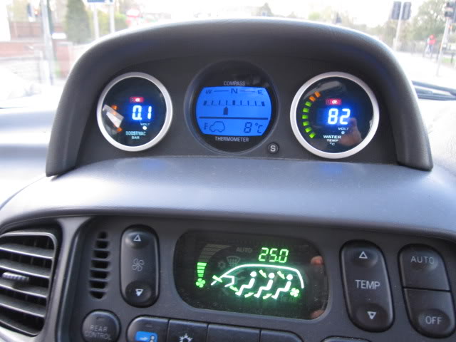

Compass on the ceiling? On my Super Exceed it's in the dash binnacle. Yes, it has a bulb that you can change, it's mounted in the back in a bulb holder which you undo by turning a quarter turn with a flat screwdriver. The standard bulb has a little green condom on it to give the colour, but you can bin that and mount an LED with not much effort. I went with blue :wink:

Well that's a new one for me. It. Didn't know the binnacle came with 2 different digital displays. The one I opened was in/out temperature only.
Pat: if you have the dual display type that Diver showed you should go back into your gauge and see where that removable bulb is.
