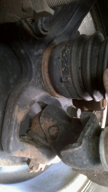

I finally made some time to fix my squeak. I have the upper ball joint out but the lower one I'm having trouble pulling out of the suspension arm. I still have the hub/axle shaft and the tie rod connected. What do I have to disassemble? I'm hoping taking the tie rod ball joint apart will give me the wiggle room I need.

The lower ball joint is inserted into the spindle mounting hole from above so you need to pull the CV shaft to get the lower ball joint out of the spindle....there is no other way to do this.
There is enough room to pull the CV axle by loosening the bolts at the inner CV joint and removing the C-Clip on the outer stub shaft. Once you open the front hubs you will see the clip.
The axles can be slid out without hub disassembly but since you're in there anyway you can check your spindle bearings and see if they need to be regreased.....ah the fun never ends!
Read up on CV axle removal in the Forum's Tech Section. Parts Source has a free loan a tool program and should have the 4WD Hub service tools....and yes they do fit the Delica.

After not finding anything too clear on CV axle removal on the forums, I went back to the actual van and found the C-clip to which you were referring. It was hidden under a lot of grease... Everything went nice and smooth after that.
I really appreciate all of the help.
