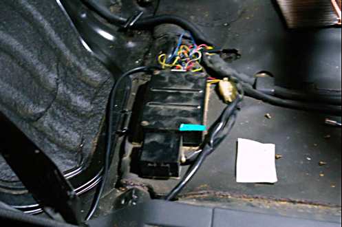

One other thought: My wagon came with a cheap remote keyless entry that didn't work when I got her, many wagons did. Take out your driver's seat (four 12mm bolts) and see if there's a little plastic or metal (or both) black box under it. If you see this box then your wagon most definitely originally had a central locking system.
Having prattled on about historical L300 semantics ~ you have a door missing central locking equipment. What are you planning to do about it?
P.S.: You know about the vehicle search engines in Delica FAQ, right? Scroll down to the JDM Online Catalogue in Useful Links for Vehicle Part Identification Purposes and put your VIN (P25W-XXXXXXX) in the Mitsubishi field and when your OEM parts page comes up ~ click on "43-Door" and see what it came with.
