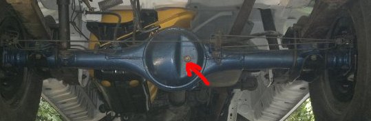

there's a 24mm nut on the rear of the diff housing halfway up it, this is the filler plug and you squirt diff oil in there until it starts dripping out that hole. here's mine .
also, that area , the rear center bulge, is where it might be more likely to be rusty as the metal is much thinner there. i recommend getting a power washer / water blaster or just a wirebrush and clean the heck out of it and look for drips.
as for welding it up, you'd have to have it removed, cleaned out of oil, welded, and reinstalled , probably cheaper and longer lasting to get a second hand one if you can find a good one the correct ratio. or get a crappy one with a good housing and get your internals swapped into it
