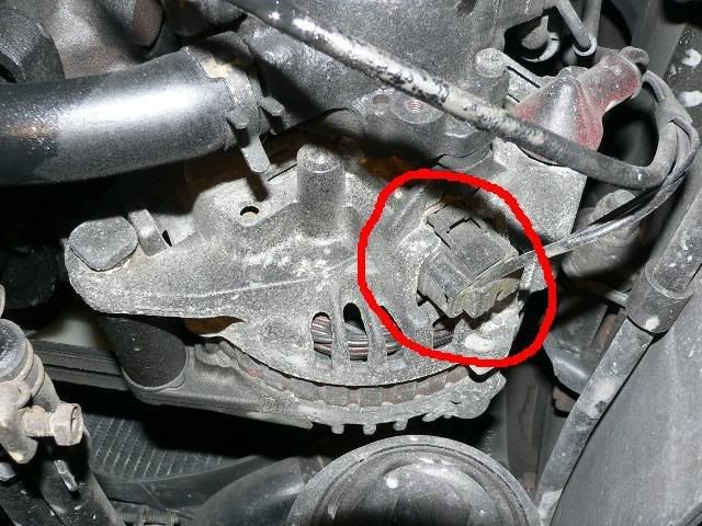

I can't find it on mine, this is what I see, which is, as you say, different:

If you unwrap the wire on this connector, there should be 2 wires, one for the dash light and one for the tach.
Hope this makes sense. I have to go back a bit in the memory bank to recall the original alternator.
James
James

When I emailed that pic to our mechanic friend who is wintering in Mexico he said it did not look like the alternator had the required 'W' terminal where I could pickup that signal. However, it sounds like it may be worth a try.
