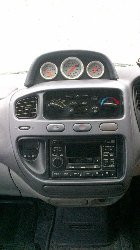

The 2 1/16 gauges from Autometer fit perfectly in the spot where the inclinometer and volt meter go.
Autometer also has a 2 5/8 Pyrometer that can be installed where your tempurature device resides.
It takes a fair amount of careful sculpting on the backend to make it fit right.
I can PM some photos of my setup if you like.

I put a boost gauge where the inclinometer was and an EGT gauge where the voltage meter was.
Be aware there is some fidling-trimming-thinking involved as the original gauges are kind of built in so they need to be removed and remnants of the mounts need to be trimmed out of the way while leaving enough bits behind so the new gauges can affix to something. Not difficult but it is not just a simple pop the old out pop the new in.

Granted the L400 does not come stock with a Pyro gauge, nor a boost gauge but I refer to mine constantly when I know the engine will be pushed. Excessive high heat on a turbo assembly is just bad news. I also use my pyro as an indicator to make sure the exhaust temps are between 300 and 400 degrees before I shut the engine off......personal choice.
- boost.jpg (66.01 KiB) Viewed 7104 times

It would be helpful to see how you guys did the installs. I guess once I decide which gauges go where, I'll revisit this post for more questions or do more searches on the net. One question arises now: can I splice in to the already existing wires that come to the console for power? What about sensors and probes. How do you lead them into the engine bay?
