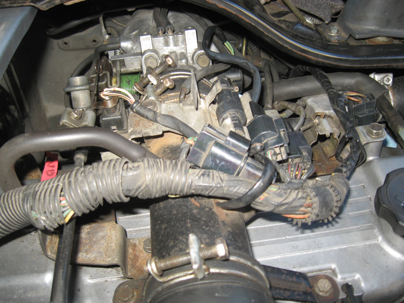

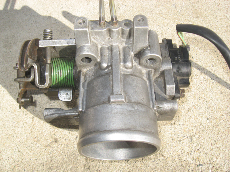

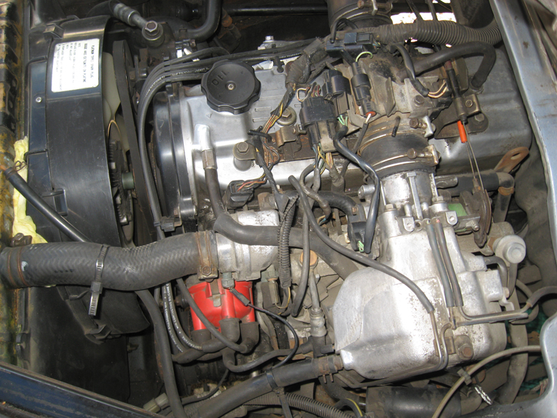

Having trouble locating the Idle Air Control Valve (if the van has one...).
Any suggestions?
Any suggestions?

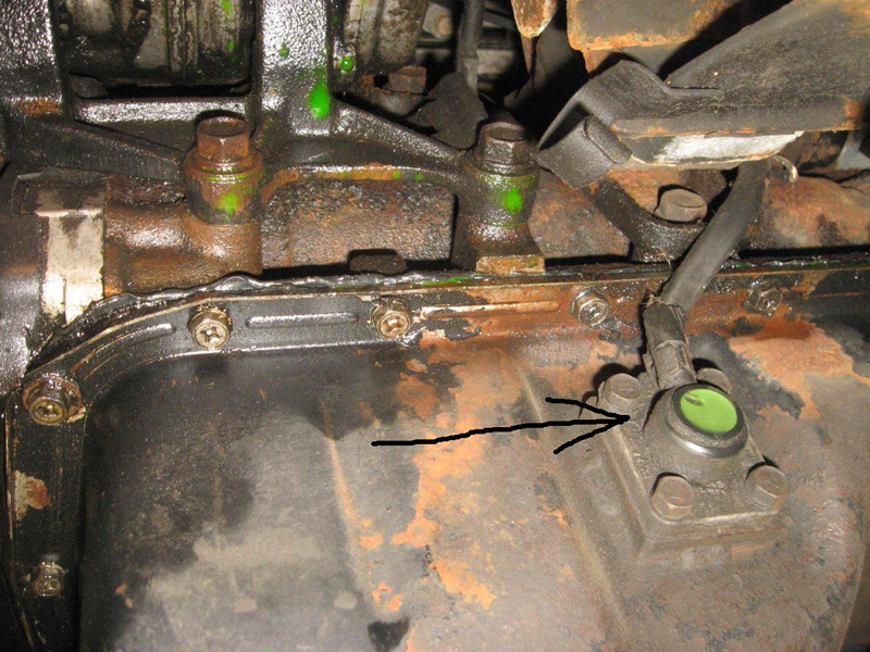

You should check to see if the "B" timing belt (small one for balance shaft) is installed correctly. Also, you have to make sure that the left side balance shaft is also aligned during installation. If any of the timing or balance shaft alignments are off, then you can have vibration. The Mitsubishi 4G6X service manual has details on this. Also, the alignment marks "1" and "2" should align. You man need a small mirror and a thin flat metal ruler or similar to be able to determine that the marks are aligned.plamen wrote:Additional info on the car performance:
rough idle; engine excessive vibration; I suspect rich fuel/air mixture: spark plugs show a little black carbon deposits and exhaust fume smells gas.
When cold, the Van starts with the help of the gas pedal to maintain 650-800 rpm., otherwise it goes down to 500-400 rpm and dies. After 3-4 min, when warm, it maintains 800-900 rpm. If the engine is warm, it starts without gas pedal help and runs good. When changing gears from "park" to "reverse" it "kicks" (possible cause high rpm - ?)
In a shop a technician detected by computer throttle valve "open" at idle – he said it had to be "closed" - (different than the error code #15, I detected)
During driving at low speed, the car "jumps" (mostly when the engine is cold).
Thanks,
The best thing for error code reading in OBD1 is an oscilloscope. You can use it to count the voltage pulses from the diagnostic connector. I have a small portable one, and I just put the positive into the diagnostic pin on the connector (and ground the scope on on the ignition key).
It also seems that you are missing the idle controller. It appears that you need the first version of the controller. The first version had a large solenoid on top of the engine that then operated the throttle. The later version has has a space where it bolts onto the throttle body, and it will say "MIKUNI" on the top next to it.
Of course, you could convert to the later system using a 1990 Mighty Max or a later van. It uses the same high impedance injectors as the 89/90 vans (to make sure of what injector system you have, take the battery out and look behind it, if you have the early 87/88 system then you should see a metal box bolted there with a bunch of wires coming out of it).
I can see about getting the idle controller off the van in the salvage yard, as far as I am aware they still have it.

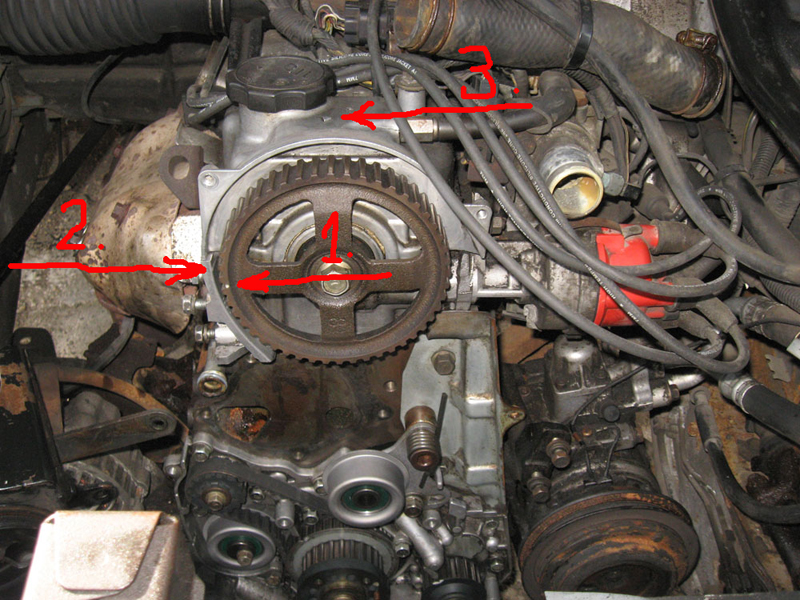

Regarding your notes on the timing belts installation:
1. The timing belt and the "B" timing belt (small one for balance shaft) were aligned perfectly (using mirror and camera).
2. The left side balance shaft alignment: I couldn't find the mentioned below plug to perform #1 under "Installation" as shown in the instructions below. So I positioned it at the "most likely/appropriate" position - I assume it contributes to the vibrations in the engine... (I did ask for opinion/help my 3 neighbor-mechanics - they were unaware about the balance shaft alignment). How urgent is this issue, and where exactly could this plug be anyway (#10): Regarding the OBD1 Engine Error code 15 (there is a Maintenance light on, as well):

Regarding the missing idle controller:
This is unexpected news to me. They sell the IAC at AutoZone, as they said the Van/engine is equipped with it http://www.ebay.com/itm/Idle-Air-Contro ... 383wt_1136.
I'm wondering how the van worked 5 years without it (and the first few years almost perfectly)? Can someone post a picture of the throttle body with the idle controller attached? We are talking about one of these, wright? http://www.ebay.com/itm/Idle-Air-Contro ... 383wt_1136
Also this means I have to have empty el. plugs for the IAC valve to plug in, but I didn't find any... Can I continue driving it without IAC valve as till now, I'm wondering? And regarding the injectors, related to the missing IAC valve: here is what is in the engine (I broke the injector's pintle cap, installed it as is for now, will replase it soon): And these are all the "electronics" in the battery compartment: And one more thing for now - out of curiosity: I cleaned nicely the EGR Valve, which was stuck closed - but this did not make any noticeable difference. (I have never noticed vacuum to the valve, otherwise, just for test, plugged to different vacuum line (fuel regulating valve), it opens and car stalls and dies..., which I understand is normal)

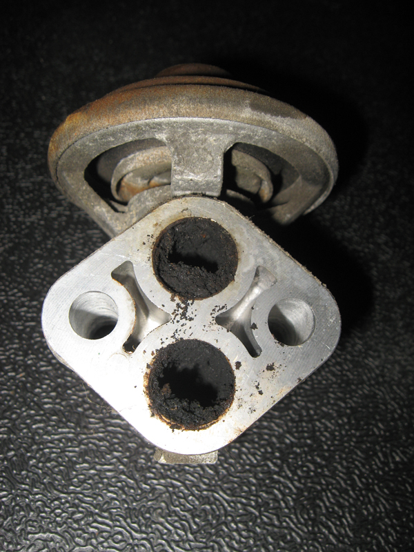

This is funny, my van does not have an EGR valve. I looked high and low for it when getting the engine running two years ago. It turns out at the time, CA was the only state that warranted EGR to meet emissions, and my van is made to Federal standard of the time.

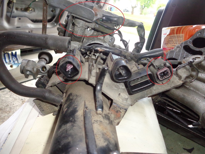

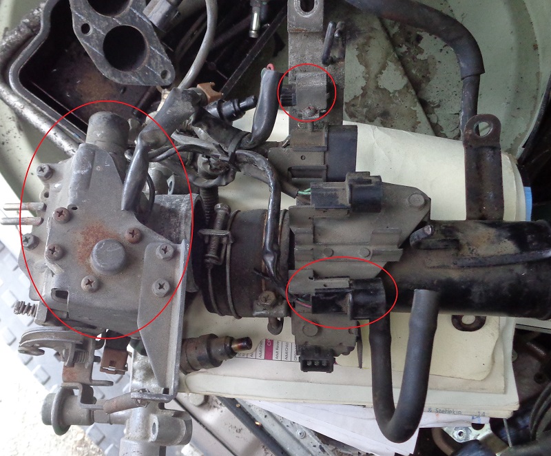

Plamen, I don't know if you ever figured this out but I was intrigued with your comment about a lack of extra connectors for your missing IACV so I took some pics of my disassembled parts. The circles show the IAC valve and it's corresponding plugs.
Here's another view. The two electrical connectors shown will in fact plug together and I think this is why you have no extra connectors. I believe yours may be plugged together on the harness side. Hope this helps solve your mystery. Oh, and the "window" on the side of your oil pan is merely potting in the electrical portion of the oil level sensor float. It does look like a cloudy carburetor site glass though.
