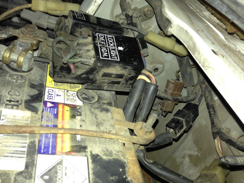

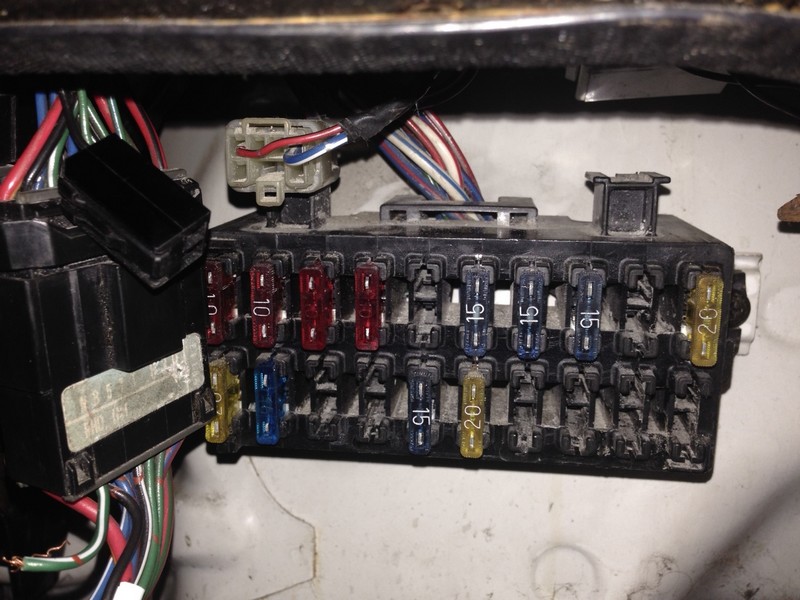

Hello,
We are in New-Zealand, we are french so sorry for this no perfect english.
We have bought a van (Mitsubishi Delica L300 - 1991).
We have an electric problem since one week ago.
When I put the light, the HORN fuse break... And no rear light, no horn.
On the back of the HORN fuse there are 2 cables, when I disconnect the green/white cable, I can use the light without break the HORN fuse ...
It's weird because it worked before ... So it's a problem with the green/white cable ?
I have no fuse in the REAR LIGHT fuse ... You can look my fuse box in attachment.
I tried to look others topics but no solutions ...
http://www.delica.ca/forum/dash-lights- ... 15652.html
Where are the fuses in the battery bay ?
All the others lights work !! Even the stop lights.
If you can help us, it will be very nice !
Thanks in advance
Joanna & Marco

- connectors in the battery bay

- fusebox without the rearlight fuse ???

Re: No rear lights and dashboard lights. Horn fuse break.
I don't think it's your combo switch. I'm thinking it's either a fusible link or a burnt out plastic connector, both in the battery bay. I had this happen to me six years ago. There is another thread that is current that appears to be the same issue. OverlanderJay (site electrical guru) has posted in this thread and might be worth the peruse: http://www.delica.ca/forum/viewtopic.php?f=9&t=16620

I can't see the 2 white connectors in the battery bay ?
I took a picture of all the connectors I can find (on the first post).
Thanks a lot
Thanks a lot
They're not actually "white" per se, especially considering how old they are. Did you read OverlanderJay's post? Check around the battery bay for loose or burnt connexions.

Yes i've red his post.
I've looked in the battery bay, but no burn or damaged connectors/wires ... You can see the connectors on my pictures on the 1st post. It looks good.
Maybe i didn't find the "good" connectors ?
When i bought this van, the car-radio was not connected. I connected it and maybe it's its faulse ? I will try to disconnect the car-radio for look if the rearlight / horn will work or not ;)
