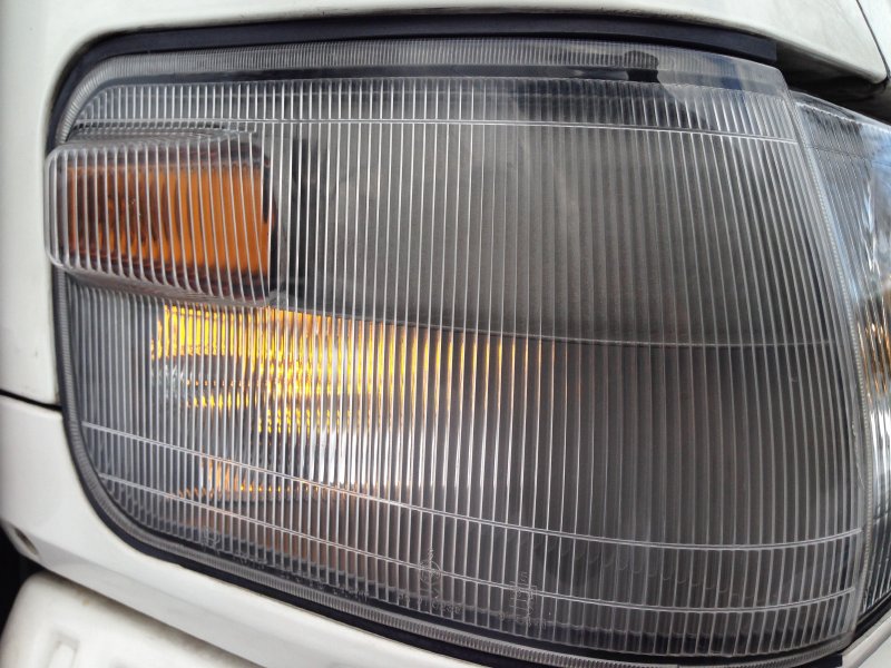

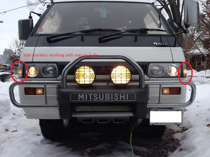

It is weird. It's the same on both sides. My regular bulbs work just fine, but I can't get any LED lights to work in this spot (side markers).
side marker working.jpg (134.24 KiB) Viewed 11494 times
side marker working1.jpg (51.98 KiB) Viewed 11494 times
It's dark now, so I will try again tomorrow.

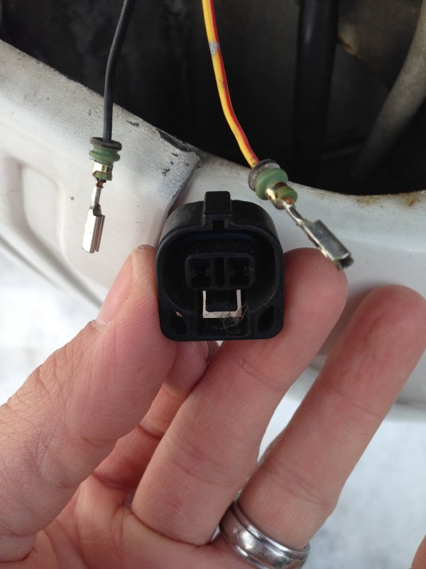

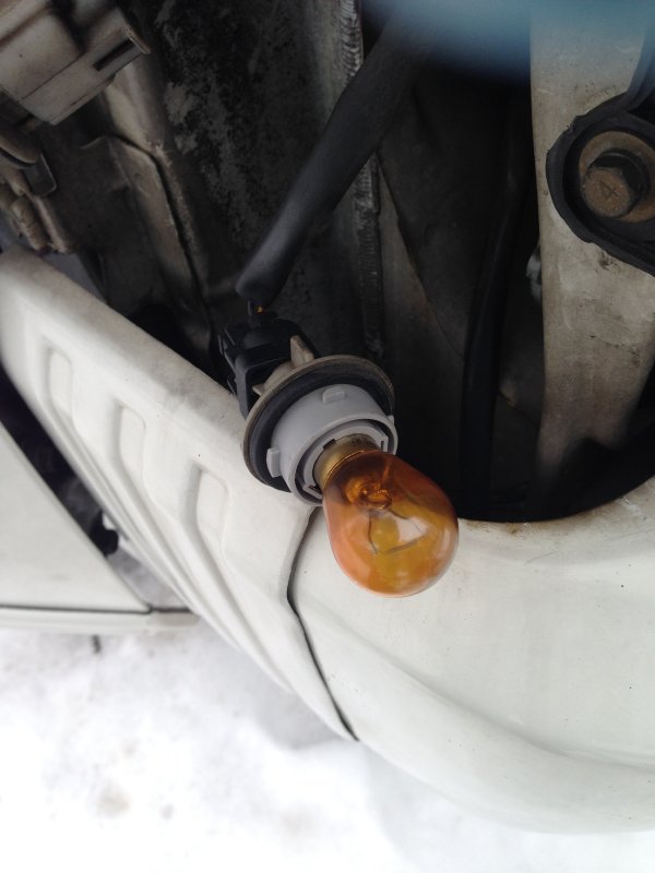

Here's what I did just in case anyone else runs into the same problem.
Take out the side marker and disconnect the grey bulb holder.

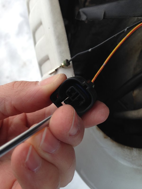

Then take a small flat head screwdriver and insert it just below where the electrical connections go into the black connector...there's a little plastic release.
side marker1.jpg (45.72 KiB) Viewed 11459 times

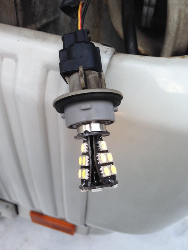

Pop both connectors out and switch them around.
side marker2.jpg (44.91 KiB) Viewed 11459 times
side marker3.jpg (57 KiB) Viewed 11459 times
Put the bulb in the grey holder, connect it back to the black connector and you're done.
