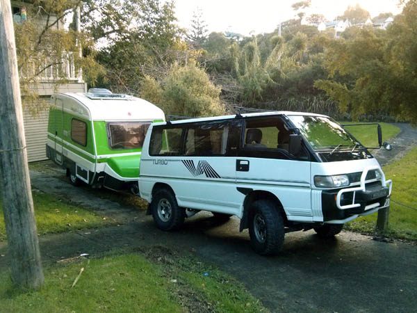

My Delica is great for towing the caravan (4 metre, max. weight about 1000kg):
When we use the car for towing you can really feel the wind resistance of the caravan at freeway speeds- but with the Delica you hardly notice any difference.

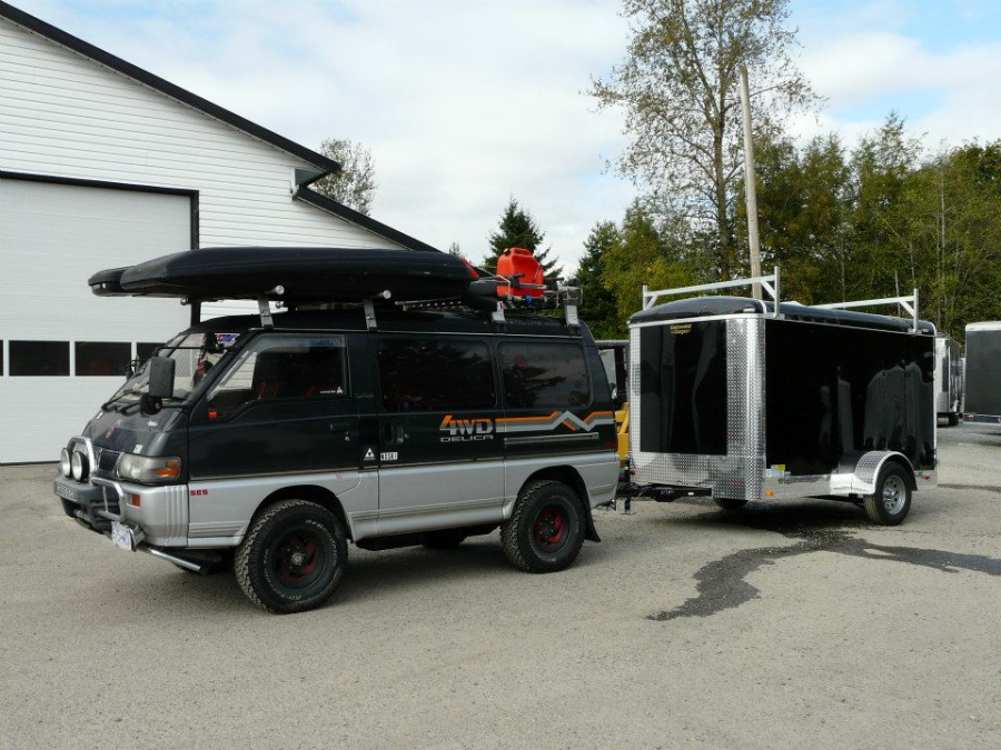

This is what Im pulling behind my van. Bought it early this year from LeesureLite. Its built for motorcycles so i only weighs in at 230 lbs empty and 18 lbs on the hitch!! When we picked it up and brought it back to Alberta from Osoyoos, I honestly couldn't even tell it was behind the rig.... its really that light!! But once we started using it to go camping, and loaded the trailer with coolers and bedding and chairs and what ever, I could tell I was pulling something. But I just take it easy and the van seems to do just fine with it. There is no way I could see myself trying to pull anything bigger than this.

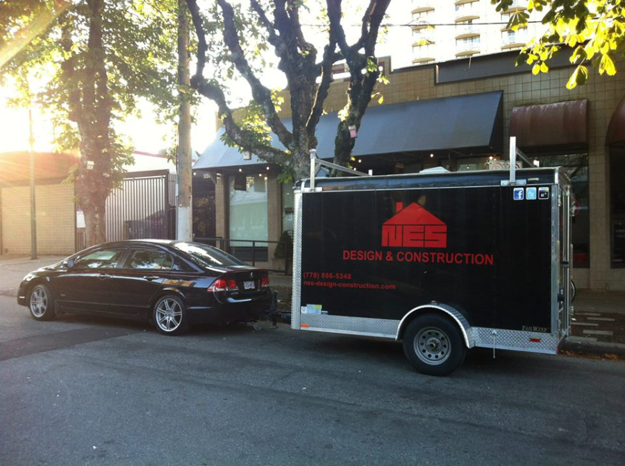

I used to pull my 6x10 cargo trailer with it. Lightly loaded it would pull no problem, but I wouldn't recommend it for the freeway. Loaded with 2000lbs was tough uphill, but doable in the city. I wouldn't recommend a 4000lb load on the freeway though, that was a butt-clenching experience.
Unfortunately now I have to pull it with my CSX, funnily enough, apart from a sagging rear, it pulls better.
