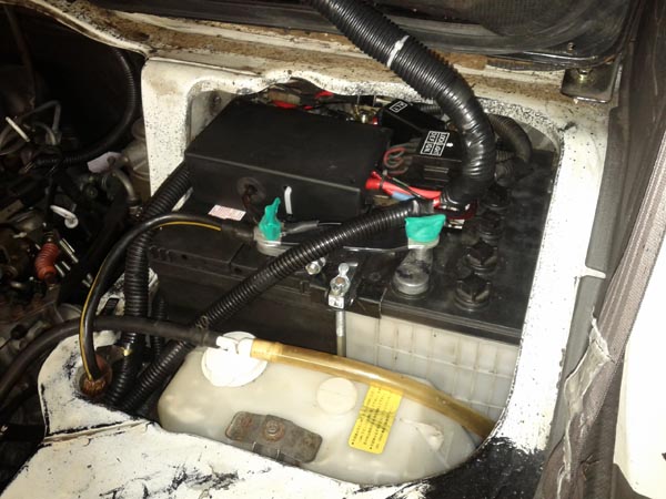

Just thinking about this... would it not be wise to connect the negative of the 2nd battery to ground, rather than to the Starter batt?
On my L300 both batteries are next to each other, so it was easier to make a link bar between them than a second earth strap- but either would have worked. (The VSR is hidden in the black box, along with a few other bits that do various things- my wiring is a bit more complicated than neccesary for a basic starter battery isolating setup).
