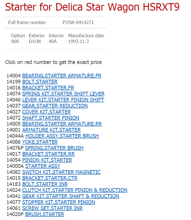

Hi JBSOC, when you get to the JDM Online Catalogue, don't enter the code (HSRXT), enter the frame number, which you'll find under the little hatch between the driver's seat and the door:jbsocdelica wrote:Hi Folks;
Thanks in advance ...
For example in Image 1 and 2, for the starter assembly, I see for part number MD164977 a period from 1989 12.3 - 1990. 07.3 (no 1993 implied?). Also, per Falco's advice (and thank you for doing this Falco on behalf of so many of us!), I have gone to the jdm parts catalogue but get an error before I can proceed (error message image).
Courtesy of Mystery Machine.Enter that number on your wagon into the Mitsubishi field and all the stock OEM/PNC numbers for your wagon will be accessible.

Re: Starter needed 1993 L300 with 5 digits HSRXT
I finally found the link to the JDM Parts Catalogue. For some reason I couldn't find it in the FAQ section.
Because I was curious, I entered your chassis # P35W-0414271 and navigated to the starter assembly. It shows OEM part # MD164977 as the one that fits your Delica
(1993.05.1 - 1994.03.3 HSRXT9 < CHAMONIX/JASPER/L-EDITION/ACT.)
Pretty cool site.
Pretty cool site.
Way cool, thanks to all, FalcoColumbarius; izack98; Muk138; punkrawker and the readers who are there in spirit.
Yes Falco, that was cool to life up the tab, and it exactly corresponded to my VIN on my registration as it turns out.
