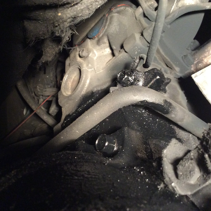

Hi everybody !
It's been a long time since i browse this forum, most of the work needed on my l300 was regular and quite simple.
For long, there has been a tiny leak of oil in the back of the engine. Last spring, i decided to change the valve cover gasket for a second time since i own the truck, because i didn't put high temp silicone on the unfamous halfmoon part the first time. I hoped it would settle it... But it didn't.
My biggest fear seems to become a reality: the head gasket appears to leak. I cleaned the back of the engine in summer. Here is a picture i took today, after replacing the 2 ujoints on my front driveshaft ( since i was lying underneath, it wasn't much of an effort!)
Do you agree that it looks like a bad head gasket ? You can see in the upper part of the picture the blue half moon part of the valve cover gasket, with red silicone.
Edit: Sorry the pic was upside down. I turned it.
Thanks for your inputs,
Davy

Re: Help on oil leak diagnosis
I think you're right. The head and turbo high-pressure oil feed is at that end of the head gasket.

Thanks Growlerbearnz,
If I choose to replace the gasket (following Tojo thread will be quite helpful), what would you recommend to change, other than the gasket itself, knowing that I already changed (since I own the truck, less than 5 years/50 000km):
-timing belts and both pulley tensioners
-water pump
-water hoses
-Injection pump
Should I get a new valve cover gasket/halfmoon part ? A new manifold gasket ? Specific bolts (i.e crank bolt, head bolts, etc) ?
Other suggestions ?
I prefer to get all the parts I need before doing the job since it is my only car at the moment.
New parts you'll definitely need are:
head gasket,
head bolts (MD040514 x18) They're officially single-use only, though Ive gotten away with reusing them.
Rocker cover seal (MD050312)
Half Moon seal- (the aluminium one is part number MD372348, plenty on ebay like so: http://www.ebay.ca/itm/MITSUBISHI-OEM-1 ... 2a55eb8728)
I'd also replace the rocker bolt seals (MD000523) though they're easy to replace later without disturbing the rocker cover seal.
The manifold gasket (MR188679) is usually reusable, but have a look around the manifolds first- if you see signs of exhaust or oil leakage from the gasket, it might be safer to just fit a new one.
I wouldn't change anything else- your belts and tensioners should still be fine, and they can be changed easily without disturbing the head anyway.
When you're changing the head gasket, make sure to clean the head and block thoroughly, then, just before fitting the gasket, give them a wipe with a fast-drying solvent (like brake cleaner). You want the mating surfaces to be absolutely uncontaminated. It's probably a good idea to clean as much oil out of the head as possible too, just so it doesn't dribble onto the gasket when you're putting the head into place.
