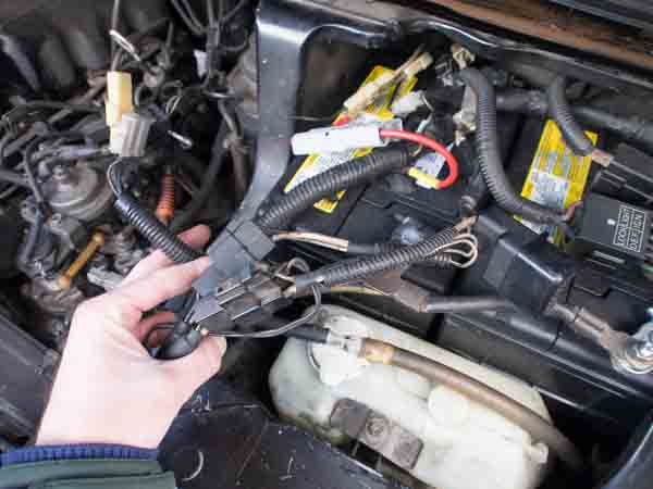

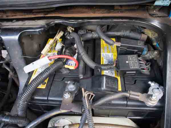

So after checking the fusable link by the battery, it was blown so i have replaced it. still not working.... tested the fuses in the fuse box - curious?!? fuse are not blown but i am getting no power to the upper and lower head fuses. are there any other links or fuses between the battery and the fusebox? I'm pretty sure they should be getting power? where to from here?

In the battery compartment You facing towards the back in the left corner are two white plugs Coming from the fusible link box .Check there connectors i've seen quite a few of these go bad .Its a bit of o pain to get at them you will probaly have to pull out the batteries to get at them. Good luck and may the force be with you Cheers Jay

Managed to track it down :-) just a dodgy connector.

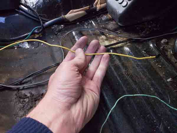

We also pulled up our carpet in the front and can see a yellow wire that's severed...can't seem to see where it should go ?

First what exatly is not working and what is working ? Highbeams? lowbeams? Markerlights?Stereo? Clock? Dashlights? Yellow wire is bot factory it could be part of your nonfuctionong PIAA foglights .

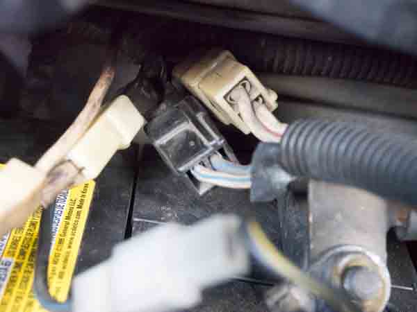

Sadly our previous issue (viewtopic.php?f=6&t=16996&p=128294&hilit=ateam#p128294) morphed into another issue...well we assume they are related. Our headlights have been working since our last fix of the combo switch but we have somehow killed our park lights, fog lights, dash lights and tail lights. We switched out the third fuse for a new one and the tail lights worked for 2 minutes before dying again (fuse not blown).

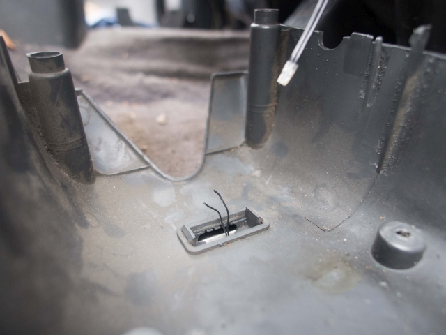

We've had a little look around but as we explained before, we are not electrically-gifted and are pretty stumped as to what we are looking at. There is two wires coming from under the steering column that used to be attached to the steering column cover (and are no longer attached - please see photo) - we thought these might be a ground ?! Can't seem to get them reconnected to test our theory though...damn those teeny tiny little holes in the plastic connector.

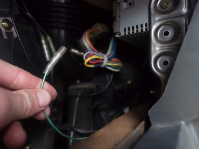

There is also a loose green wire with white stripe behind the glove box...can't seem to see where the connector would plug into / have no idea if this could be related to our problems....we read a post a while ago about a green wire which was the power source for the dash, tail and stereo....not sure if this is the same wire...refer photos.
Our aftermarket PIAA fog lights aren't working either....and the switch doesn't even have power.
Any help/direction very much appreciated.

This may seem bizarre but if you have a trailer light converter unhook it and see if your problem disappears. When they get dodgy weird eletrical problems appear. If lights are pulsing as well and the radio comes on and off it could be an alternator.

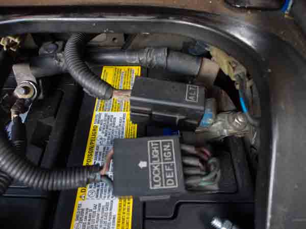

We replaced our dual batteries a few months ago so were a little worried we may have knocked one of the fusible links...but neither of us are savy enough to know how to test them.
