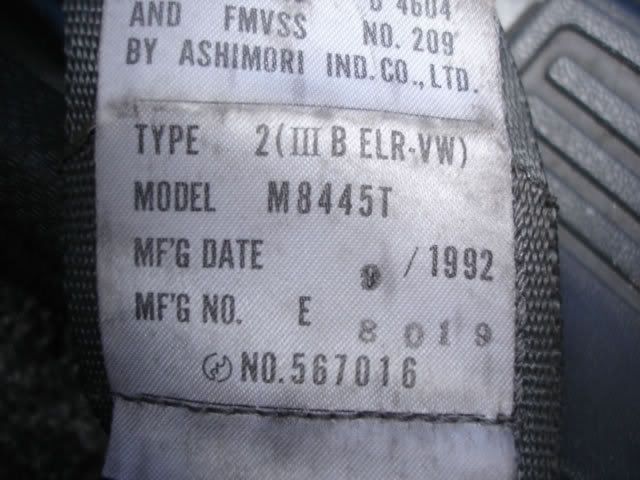

Hi Weasel, without meaning to sound rude, you can ignore some of the specs from that site because they aren't 100% accurate (a lot of the data is good - but some of it isn't correct)Weasel wrote:....which I think means it was built before August of 91...
If you want to find out the true manufacture date of the vehicle, get the seller to check the label on the seatbelt. It gives the true date of manufacture, not the model year...
This one is September 1992; the 9 is a little blurry, but it certainly pinpoints the manufacture date fairly accurately.
Early nineties Japanese vehicles were built with JIT manufacturing processes, so the date the belts were made corresponds with the date the vehicle was manufactured (+/- 21 days)
HTH?
