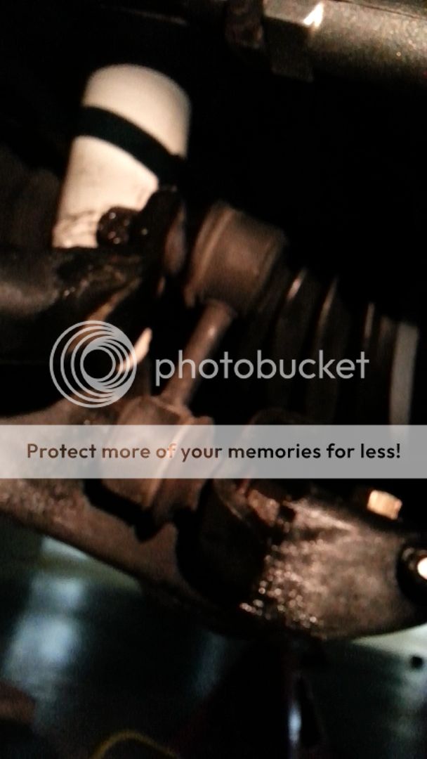

Here is a video of my left sway bar link...
http://vid45.photobucket.com/albums/f71 ... 095507.mp4
Should it be this easy to move? I couldnt unbolt it and test it because the stud rotated as I tried to loosen the nut...

Remove the ASBL from the front and back sway bar and push/pull the ball socket joint. If it has a noticeable clunk inside replace all four links.
The video is good, gave me a laugh this morning but the above applies still. You can't tell just by turning them that way. The center shaft needs be held with an allen key while the nut is turned off with a 17mm ratchet wrench.
If you do any work on your deli buy a 10, 12 and 17mm (offset) ratchet wrench. Without a doubt they are the most valuable toosl for your deli.
MD

Thanks, I have made out okay without the offset rachet wrenches so far...but I believe you, they would make life a lot easier...thelazygreenfox wrote:Remove the ASBL from the front and back sway bar and push/pull the ball socket joint. If it has a noticeable clunk inside replace all four links.![]()
If you do any work on your deli buy a 10, 12 and 17mm (offset) ratchet wrench. Without a doubt they are the most valuable toosl for your deli.![]()
MD
I didn't know about the allen key...that will make it a lot easier.
Glad you enjoyed the video
