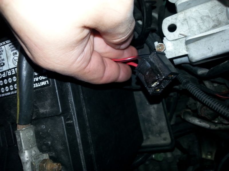

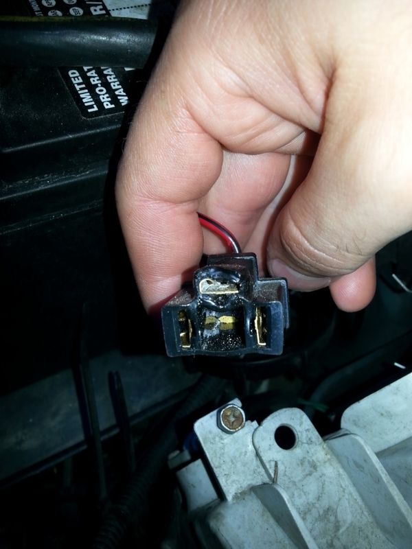

I checked the bulb and the bulb is fine. The wire at the exit of the connect is a bit frayed. I can bend it and it will stay on, but after idling for a period of time or driving the wire moves just enough to break the connection. Upon closer inspection, the plug connector looks a bit melted.
