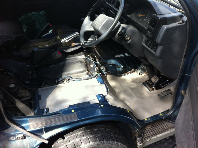

I put sound insulation foam on the front wheel wells, and in the foot wells. I did the rear wheel wells and the floor in the back previously, and it made such a difference I finally got around to doing the front.
I did this two Saturdays ago, and waited to post this til I took it on the highway, because that's the real test. The real indicator of how much quieter it is, was when I turned on the radio, and the volume was much louder than it needed to be. How's that for a before-and-after?
The foam I'm using is about 3mm, closed cell foam. Comes in a roll. I applied it with water-based contact cement. That stuff takes 30-40minutes to tack up, but I just worked it in sections, cut the next piece while waiting for the glue to dry.
(I suppose if it rolls and catches fire, I'll have molten foam dripping on me. But I mostly try not to drive that way.)
I've got another post on here about doing the back...
I might also do the insides of the door panels. I have to get in there at some point to deal with jumpy locks.

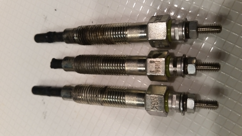

REPLACING MY GLOW PLUGS
The local Lordco sold me the Wrong Plugs NGK 2161 Y-116R1 for a 98 l400 4M40 turbo diesel manual transmission.
I didnt know any better so I installed them. OOPS
I now have a reliable and experienced local DELICA mechanic - Okanagan BC - that has connected me to the Right Parts. NGK 90066 CZ256.
Dont do this to your Deli
