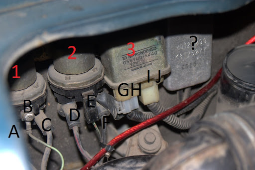

AKcub wrote:
Now to dig out a schematic and see how the gp bypass should be wired... If anyone has a link to the bypass process or the associated schematics for a '92 L300 please share.
Sorry about the crappy picture...
Relays 1 and 2 are the glow plug relays. Relay 2 sends 12V directly to the glow plugs to heat them up super quickly, relay 1 sends power through the resistor pack (marked "?") to run the glowplugs gently once the engine's running.
Your manual switch should be connected to terminal E (the spade terminal) to switch on the fast warmup, 12V relay. It's possible your switch is connected to the 6V relay rather than the 12V relay- have a look and see, and if it's connected to the ring terminal B move it over to E.
Don't expect to be able to tell which relay is active by measuring the voltage on the bus bar- the voltage you see depends on the current the glowplugs are drawing. They draw a huge amount of power at first, then less as they heat up.
Oh and item 3 is the starter relay. Ignore.

Growlerbearnz wrote:

ynwa wrote:Just to confirm, with the manual setup, all we want to do is drop the switch along the signal wire from ports B OR E? Should we have a fusible link in the way? 10A?
Spade terminal E is the one you want*. Connect your manual pushbutton to that terminal instead of the original wire. That'll feed 12V to the glowplugs when you push the button. The power to your pushbutton should be fused- either add an inline fuse (10A should be fine), or tap into a circuit on the back of the fusebox- fuse 17 or 18 (heated seats, if you have them) are powered when the ignition is on.
ynwa wrote:Also, to add to this, my relays go mental after the van is warmed up. Rapid fire clicking, nothing sequential, just random on/off in a beserker fashion. I just replaced the temp sensor. Any thoughts on the epileptic glow system?
If you've replaced the temperature sensor and it's still mental, it's time to open up the ECU and look for damaged components and/or traces. They're old technology and completely rebuildable by an amateur with a soldering iron.
*Clarified from my earlier post where I couldn't recall which relay was the 12V one.

AKcub wrote:Growler,
Just so I understand the system- On a manual gp setup there is no need for the 6v solenoid?
Correct. It'll just behave like a regular one-shot glow system, without the additional gentle heat to ease the first minute of running. If you wanted to get really fancy you could add a second manual switch which operated the 6V relay, and then hold that down until the engine runs properly- but if you're going to that level of insanity you might as well just repair the ECU.
AKcub wrote:Edit- manual gp signal wire is connected to correct (inboard) relay...
Bugger. I'd be checking the compression next, and then finally the injectors' spray pattern. And then I'd run out of ideas.
